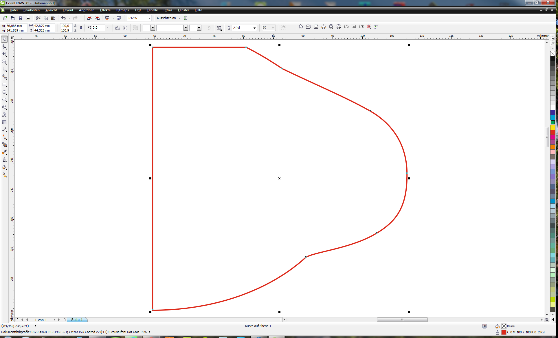

Hi, I need some help with 3d construction software.  I need to make a
Hi,
I need to make a 3d model out of a 2d shape by rotation it around one axis. I have this shape and I want it to rotate it 360° around the y-axis to build a volume.
Can somebody recommend a free software to do that?

@Thomas_Sanladerer I didn’t find a way to import 2d drawings into 123 Design. Do you know a way?
@Joshua_Porter Do you one that describes what I want to do (= make 3d objects out of 2d shapes)?
@Phil_Nolan I will try it. Can you point me to some information how to do the 2d-3d conversion?
@Daniel_Wood I already tried FreeCAD but didn’t find a way to import the 2d file without it getting changed to a complete different shape. I will try it again an maybe ask you for help… :slight_smile:

Have you checked OpensCAD? it has the ability to import DXF (I guess you can export from CorelDraw since its vectorial) and you can easily rotate.
It’s script based, however. But you just need a couple of lines of code. And then it’s repeatable with any other draw, just load another DXF file.

@Chris_Lau But how do I import the 2D file?
@Kai_Laborenz You need to export the drawing to .DXF file. You should be able to open the .DXF file in Autodesk123D
Actually I can’t - we’re speaking about #Autodesk 123 Design in the free Version, right? I have tried both the desktop version (there is no import at all) and the online version. There is an import option (but not for dxf) and when I use it the shape is conferted to a 3d object instantly and I cant use the revolve tool anymore…

openscad: rotate_extrude(…) import_dxf(…): should do what you want.
