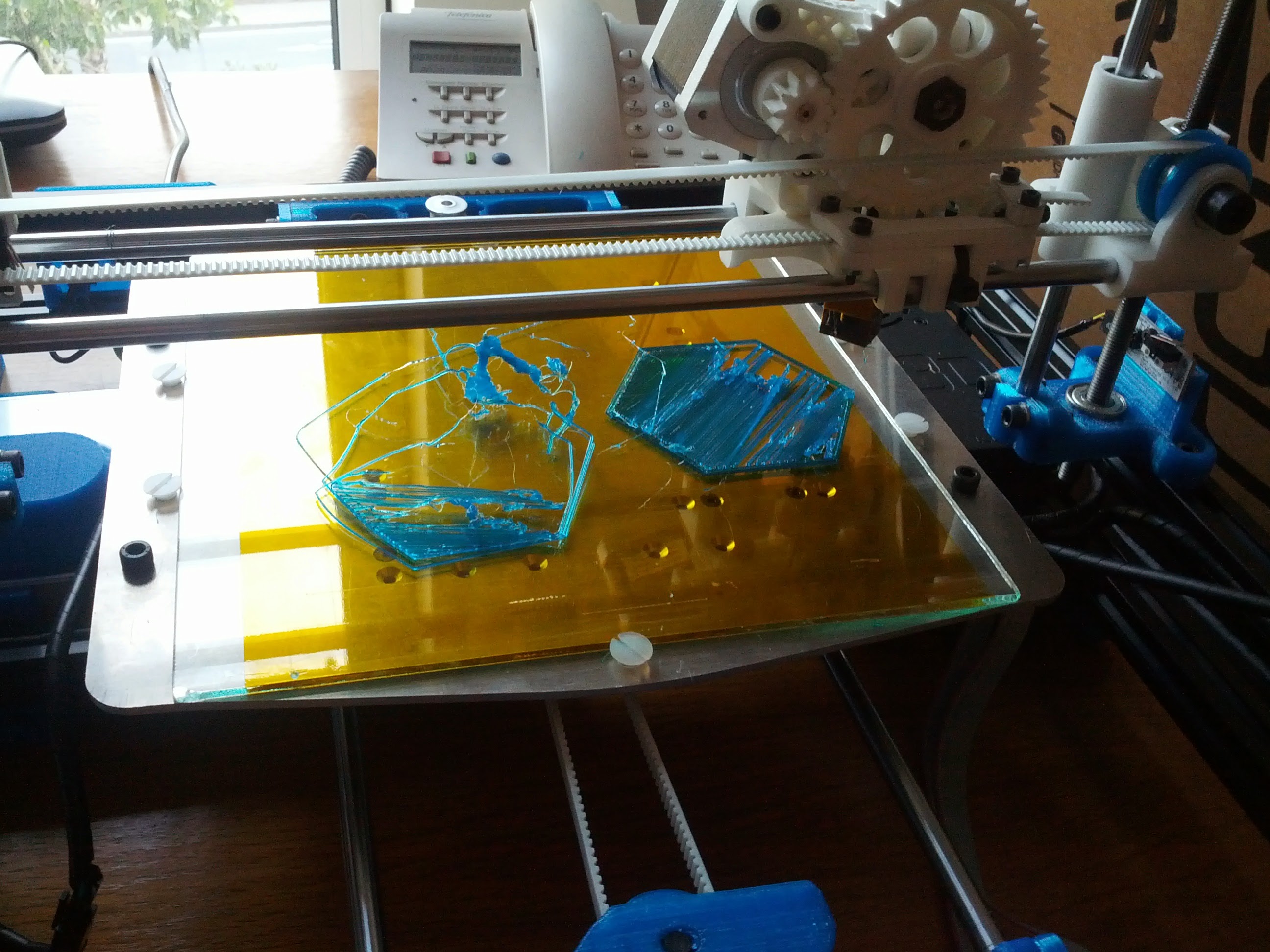

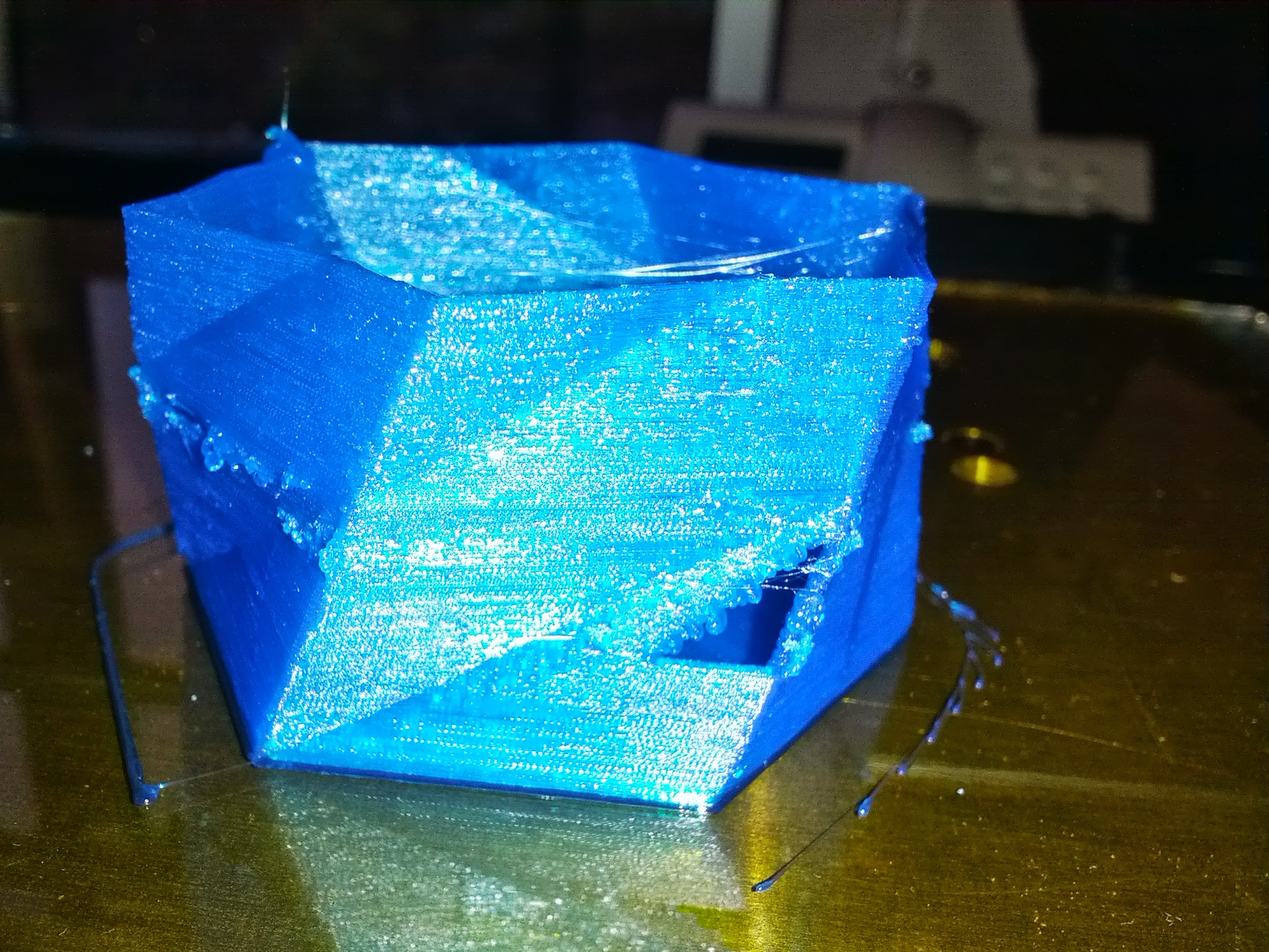

Here the pictures that belong to that with the second attempt and the final result.

Nice, what was the cause of the issue?
Printing with Pla with no fan and object too thin. Had to lower speed and temperature and add a second object to let material cool down layer to layer
