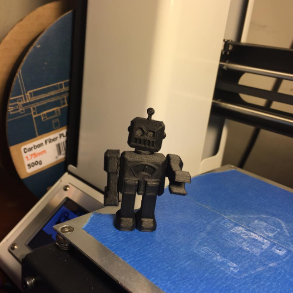

@Adrian_Beckett It works great out of the box. It’s cheap (under $200 on Amazon right now). Here’s a photo of a print done in Proto-Pasta’s CarbonFiber PLA.
@Adrian_Beckett Tom sums it up perfectly:
