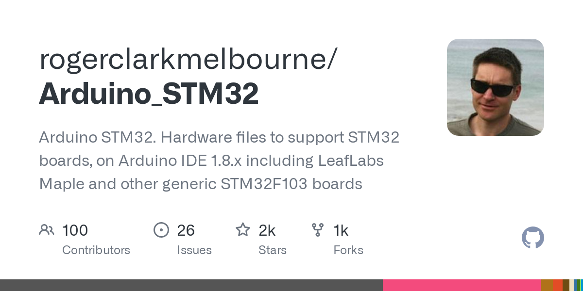

Hi, I want to use fastled for STM32F103, I install this boards:

I install last version of FastLed and Arduino_STM32 boards, and select maple mini but error exist still:
