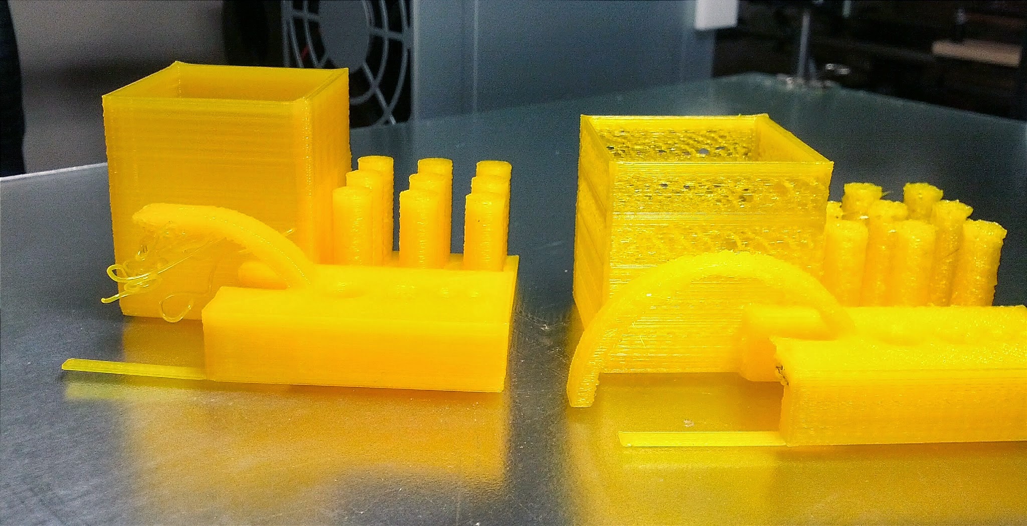

Hi, If I could pick your brains for a moment, I 'm having trouble printing on my latest printer… (ingentis / Eustathios / rigidbot). On the photo, i’ve done a torture test. On the left, my old trusty Prusa I2 /w direct drive filament. On the right, my clone using bowden and airtripper’s extruder. both have the same setting to print out. 80mm/s with 205C temp. they both have a J-head (the prusa has a brass ending while the clone has a aluminium one). both tests were made witht the same spool… Has you can see, the clonde is having trouble printing.
Its got a Nema17 step motor with a MK8 gear. its set to 149 in the firmware with a 1/16 step. I dont feel # hear the stepper skipping so I dont think thats the problem…

Could be a temperature issue. The one on the right looks too cold to me. Maybe try cranking it up 20 degrees or so. Maybe your thermistors aren’t calibrated equally. I know on the e3d v6, you have to make sure the thermistor is secured all the way inside the heater block or it will read low, especially when the fan kicks on.
@Jason_Smith I did one @ 215C and it looks a bit less messy but still has some problems on the layers. I have #1 as the thermistor in Marlin… maybe #5 would be more appropriate.

It definitely looks like either it is under-extruding, or the temperature is too low (assuming the filament is not simply getting chewed up and skipping on the hobbed bolt/gear).
If under-extruding, it could be the stepper skipping or a calibration problem. Since you’ve nailed the extrusion length, skipping steppers might be the problem. Are they getting too hot? Or perhaps the driver chips are getting hot? Do you have heat sinks of the driver chips?
If the extruder stepper motor or the driver chip are both not too hot, then Occam’s razor likely applies and it is probably the temperature.
If extrusion temp is low (what it looks like), then maybe try going up 5 deg C increments and re-print; repeat a few times, but 20 degrees is probably too wide a range since it is already melting.
@SirGeekALot I tried 200C, 205C, 210C, 215C, and now 220C, all the same…

Check the actual nozzle size. I am sure you are under-extruding, if your calibrations are correct, than it must be a setting. I am betting the actual nozzle size is larger than what it is marked. This would cause an otherwise properly calibrated printer to under-extrude.
Also check the filament diameter in several places and around in each place. This looks like maybe the filament size is smaller than programmed in the software.
