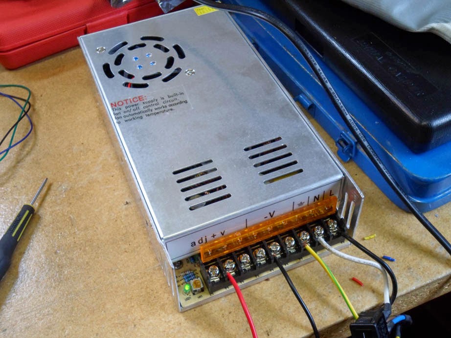

Hi, I'm building a 3d printer and was wondering about these power supplies.
Hi, I’m building a 3d printer and was wondering about these power supplies. some people say they fry after a week, but then i see them in all the Reprap kits and most home builds. So i just want to find out what you guys think about them.
I use this type of power supply myself.
What I have had as far as bad experiences with them have been very few. I have had them last years in constant duty cycle (ON always). What I can suggest is buy the one that’s about $30 on average. they seem to last quite well.
Meanwell clones? They’re relatively decent. As always, get them with a bit of headroom and they’ll likely last forever.

With the MeanWells, you get proper mains isolation and protection
(they didn’t skimp there), proper thermal management with temperature sensing–in the knock-offs, the “auto fan control” just means the fan is permanently on, and great manufacturing quality.
The knock-offs have a lot of left-over flux residue from the manufacturing process, and I had to take them apart to re-solder some components and hot-glue some stuff down.
I guess the key to using knock-off power supplies is to give yourself a lot of headroom, but with MeanWells, you don’t have to worry that much

All I can say is plan to replace the fan. The PSU itself has worked for me without complaint for about six months of heavy use, but the original fan started making awful noises within the first month of use.
I replaced it with a dirt cheap generic fan from Newegg or Amazon and it has worked without issue since.
Or don’t.
I love these rules… Don’t you think it has a lot to do with the quality of manufacture?
Just as I never replaced the fan in my computer PSUs, I’ve never seen the need to replace one of these for CNC or 3D printers. The machines make more noise than a 3" fan.
tbh @Mark_Rehorst I think if you have ‘burned through a couple’ then you have the wrong rating, a poor knockoff or generally doing something wrong with it. We have used over 90 of them in repraps running over the last 2 years without problems
I’ve been using this style and have yet to burn one out. One has a noisy fan which I should replace soon. If anything, make sure you get one with the plastic piece that covers the terminal strip. Power supplies and RepRap electronics should be inside a protective vented enclosure.
