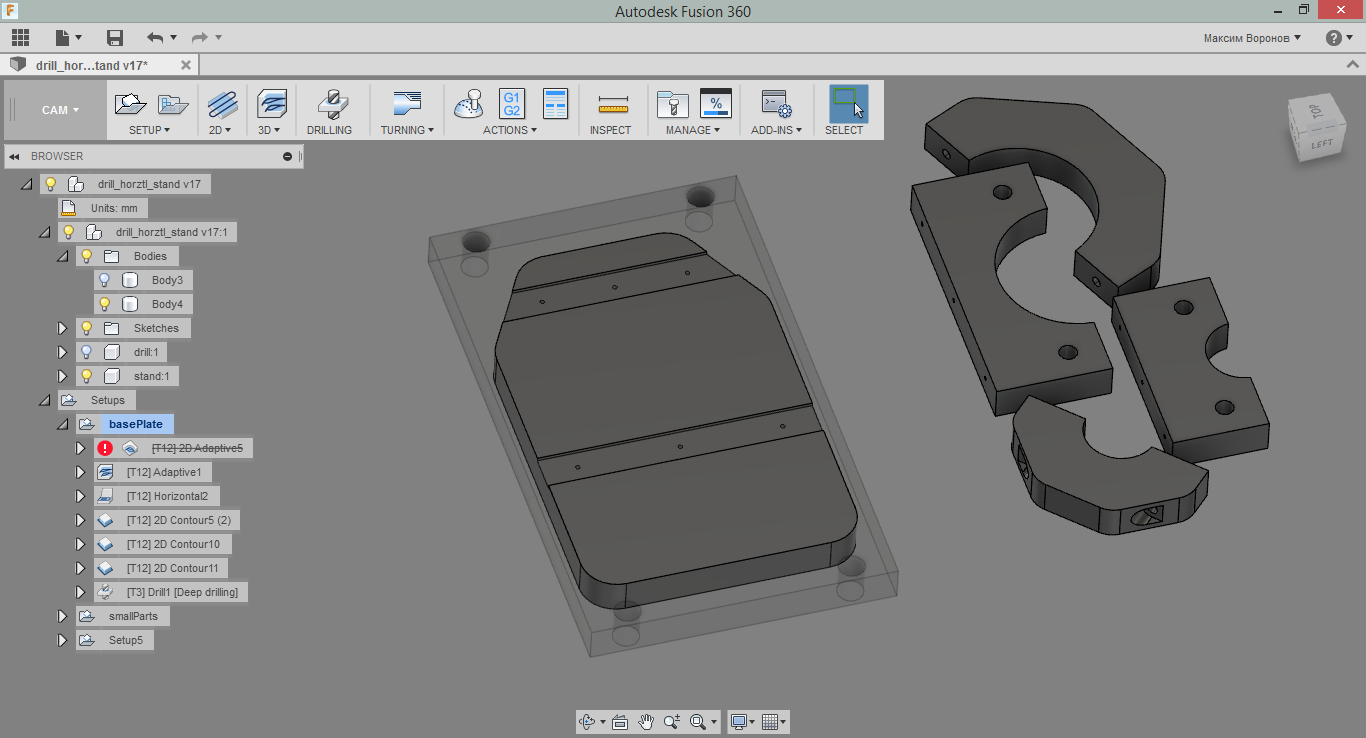

I’m currently using GRBL workspace as front-end for my CNC router and got weird problem with tool change routine on M6 g-code command. Position for tool return was way off and I broke one of my twist drills :slight_smile:
In Autodesk Fusion 360 I’ve made few operations with 1/8 end mill(on picture it’s from “Adaptive1” through “2D Contour11”, tool is T12) and one with twist drill(op name is Drill1, tool is T3). Everything was running as expected until I’ve clicked on “Send Position” button as completion for tool change routine, coordinates were way off and I did not noticed that, results as usual were quite unexpected :slight_smile:
As you could see on second picture coordinates for tool return are X102.19 Y272.087 Z3 but in NC-file last coordinates before tool change are X52.721 Y271.98 Z37.1
