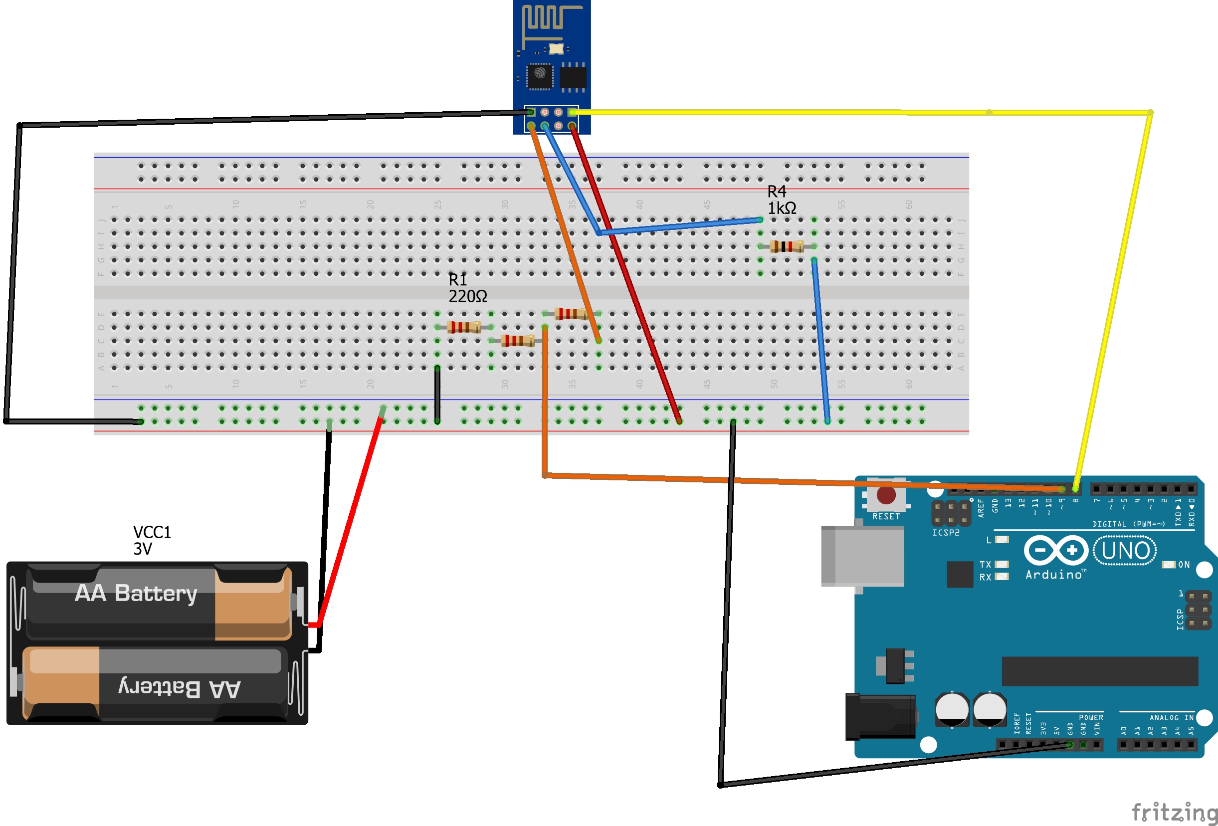

Hi, I’m doing some try with the esp8266-01 module wired to Arduino UNO as in the diagram below and using as library the AltSoftSerial. But on friday last week it’s happened something… strange! In the morning it worked perfectly, in afternoon sometime, and in the evening definitely no.
I tried to change all the cables because I thought that was a problem of them, but it’s not this!
I also thought I’ve accidentally changed the code, so I tried with an example sketch but I got the same result…
Someone has already tried to connect the esp using this library? If so, can you post the diagram? Thanks

soft serial is to slow for arduino uno. you can use uno serial only. because baudrate 11520 is needed for esp8266!
@Andreas_Zwiersch may I utilize hardware RX TX for serial communication with ESP? And the man says that everything has worked in the beginning…
Software serial is unreliable with the esp and bluetooth modules (AT mode), bit you can get around that by eliminating the arduino entirely.

Check out the different voltages of ESP (3,3V) and Arduino (5V). Condensator > 100 uF helps for much more stable power to ESP. Therefore the voltage divider is right for ESP RX. It works also fine up to 1 K Ohm. Yes, hardware serial is much more stable for needed 11520 baud rate. Flashing ESP with arduino IDE needs more expierence (see http://hackster.io URL). With serial connection to Arduino you can use ESP AT Commands for what you like …
