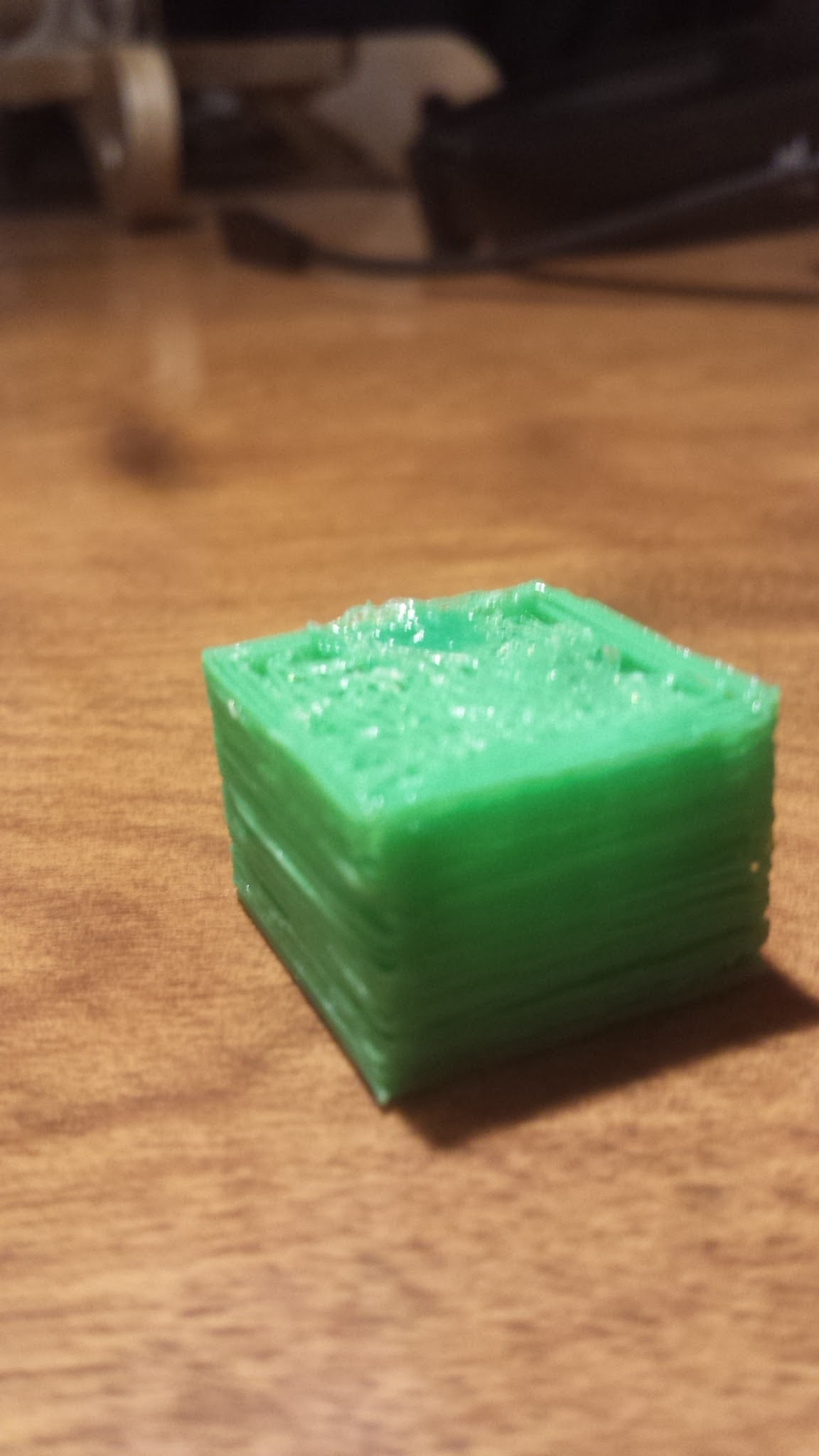

Hi, I'm fairly new to 3d printing and could really use the help of
Hi, I’m fairly new to 3d printing and could really use the help of some people who have experience. I built a Hesine Prusa i3 (I know, a cheap printer) and I got the thing working. However my 3d prints seem flimsy since the layers of PLA don’t stick to each other even though I tried printing at 220 degrees and the belts are fairly tight. The edges of all my prints are sloppy and the infill is very weak.
I expected to do some tweaking and trouble shooting to this printer but I don’t know where to go next.
Thanks, Adam
It’s possible you’re printing pla too hot. Have you tried lowering the head temperature?
I tried at 190 also, and the temperature change didn’t seem to change the outcome. Could it be the extruder motor or a cheap or flawed hotend?
It looks like the layers aren’t stuck together. You’re either under extruding, or your calibration is off, or since it’s self built your Z calibration might be off. Measure the box and see if it fits the dimensions intended. Keep us updated please. Thanks.

That’s a very poor result. It looks like mechanical wobble. The X-Y positioning is all over the place.
My first reaction was that the belts needed tightening, but you have already tightened them, so some other mechanical part seems loose.

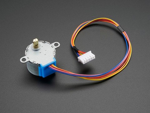

What steppers are you using? I have seen images showing poor positioning when someone used super-cheap steppers with an internal gearbox like these:
I’m sure you don’t have anything that small in your printer, but maybe there is a sloppy gearbox in the ones you actually have?

@Nathan_Walkner It doesn’t necessarily have bad layer adhesion because it doesn’t look like the layers were printed to far apart for the plastic to get the chance to adhere which make me think it’s the calibration.

@Adam_Potter 0.4 mm layer resolution? Then I’d have to agree with @Nathan_Walkner that you’re underextruding. Let me know how the recalibration on the extruder goes.
@Adam_Potter ​ no I bet your issue is that you have too high of a layer height. You shouldn’t go over 80% of the nozzle size per layer height.
I use a .4mm nozzle and if I go about .3 I get terrible results. Drop down to .2mm layer height and share another picture
@Adam_Potter
@Griffin_Paquette has a point but the X/Y dimensions still don’t have enough extrusion. Even printing 0.4mm you should get decent X/Y adhesion but you’re severly lacking. I’d still go through with the extruder calibration just to make sure.
