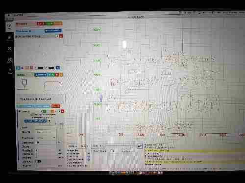

Hey @Ariel_Yahni_UniKpty , here’s a link to what I think that file was: https://www.dropbox.com/s/clpkg6kjp6qyi52/So%20I%20can%20Kiss%20copy.svg?dl=0
@Gordon_Williams , I didn’t mean to hijack your question. Ariel is one of the best though and I’m sure he will end up helping both of us…
Took me about 1.14. how long does it take you?
Do you get behaviour like the video while cutting?
I’m assuming you mean loading the file took 1.14 seconds or that’s how long it took you to generate the gcode? Loading this file takes me upwards of 30 seconds. Generating the gcode can take 10 minutes on that file. When cutting it behaves as it does in the video I posted in the other thread.
I meant generating 1 minute. Will check the other one tomorrow.
Yeah, generation takes a long time. I should mention that the layers are inside cut, outside cut, etc.
