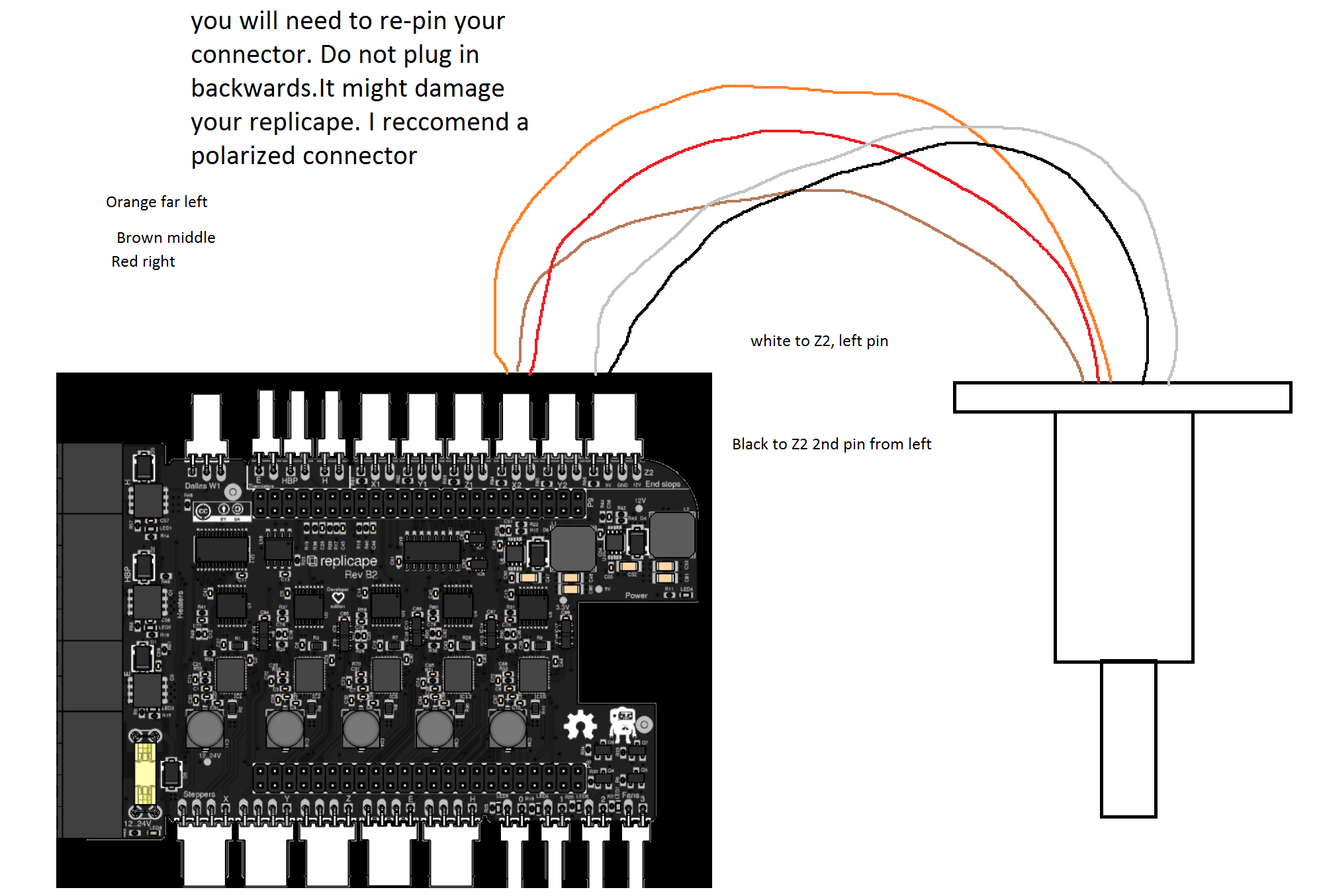

i just wonder. how do you connect bltouch (auto leveling sensor) to Replicape
and how to program it ?
Here you go. This isn’t all my work, but it works.

G28 Z does not act as expected with bltouch (at least with cartasian printers). I have mentioned the issue. Do not use G28 Z with cartasian unless your printer likes crashing the head into the bed. PM me for a workaround on slack. pr1mus285 username.
@Andrew_Dowling
Hi thank you i havent recived the card neither the bltouch yet but I want to be prepared :slight_smile:
When I connect it like this everything goes black…
Does it turn red with just the 3 pin connector connected?
and then when you connect the white and black and it just turns off?
