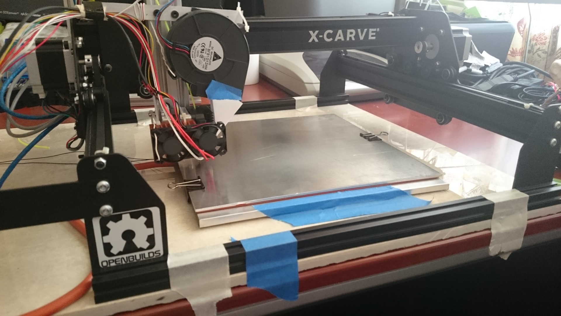

Hi I'm new to 3d printing and I converted a x-carve in a 3d
Hi I’m new to 3d printing and I converted a x-carve in a 3d printer. Its currently has a azteeg pro board and is running marlin. I would like to know how i can configure my heated bed.
In configuration.h go to the heater settings and set the bed as either bed or e1. And set the bed thermistor and limits. And pid.
Nice! What’s the max build height?
@ james thanks, for now about 3in. Once I get this going I plan on printing brackets to build a taller base.
