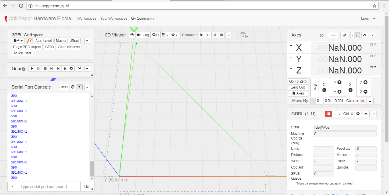

I’m using grbl 1.1f on my Arduino Uno based CNC, along with ChiliPeppr in Chrome.
However, when I connect to the COM port of my Arduino (successfuly - I can issue grbl commands and jog the axes), I get NaN mm for the X, Y and Z axes (prior to connecting these values are 0 mm. To demonstrate this, please look at the top right i.e. the Axis widget in the following image:
Hi John, thanks for the swift reply. I didn’t realise the forum existed, I assumed this was the place for help.
I’ve just been across and searched for my issue “NaN” and have only found 3 threads, none of which are to do with my issue. Is there any chance you could provide a link to one of the relevant threads please?
NaN stands for ‘not-a-number’. Make sure that your serial port is set to ‘grbl’ and not ‘default’, which I think is default setting after you launch /grbl workspace or any other setting (drop-down list in the Serial Port JSON Server next to your ArduinoUno board).
Thanks Sebastian for the reply, I have my serial port set to grbl.
On another note I have a weird issue with the auto level function. I set my z axis to a point just above the PCB and then run the auto level, it descends till it touches the PCB and the alarm goes off as it should. But then it seems to hang there instead of move up and to the next probe position. I don’t know if these two issues could relate to the same underlying problem, but either way I need to discover the cause.
