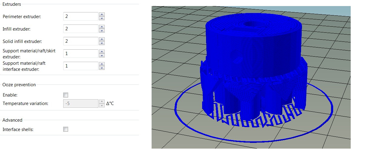

I was using 1st extruder(BLUE) for part and 2nd extruder(RED) for support printing. Yesterday I changed the extrduer settings in slicer so that 1st extruder will print supports and 2nd one will print the part. But after slicing , in the print preview everything was under extruder 1 (both supports and part printing).
I checked gcode, there’s no T0 or T1 command
Why is that?

extruder small gear 1 = extruder 1 for part and extr 2 for support
extruder small gear 2 = extruder 2 for part and extr 1 for support
I’m not sure it’s a bug but I’m also not sure if you can do what you want.
With a multi-extruder profile selected, the Multiple extruders settings under Print Settings shows what features can be assigned to an extruder.
If those settings only permit changes to the extruder for Perimeters, Infill and Support then I believe the basic premise is that Extruder 1 will primarily be used for normal printing and those other features can also be assigned to Extruder 1 or passed-off to Extruder 2.

@Neil_Darlow I think I figured it out, but still needs testing(currently in the middile of a 33hr print, I’ll test it after that)
@Gary_Deen
I’m using windows
If I select the extruder as 1 in the drop down window near the object (repetier object loading), I could only use extruder 1 for part printing and extruder 2 for suppost, can’t to reverse.
But if I select extruder as 2 in drop down window, I can only use extrude2 for part printing and extruder 2 for support.
