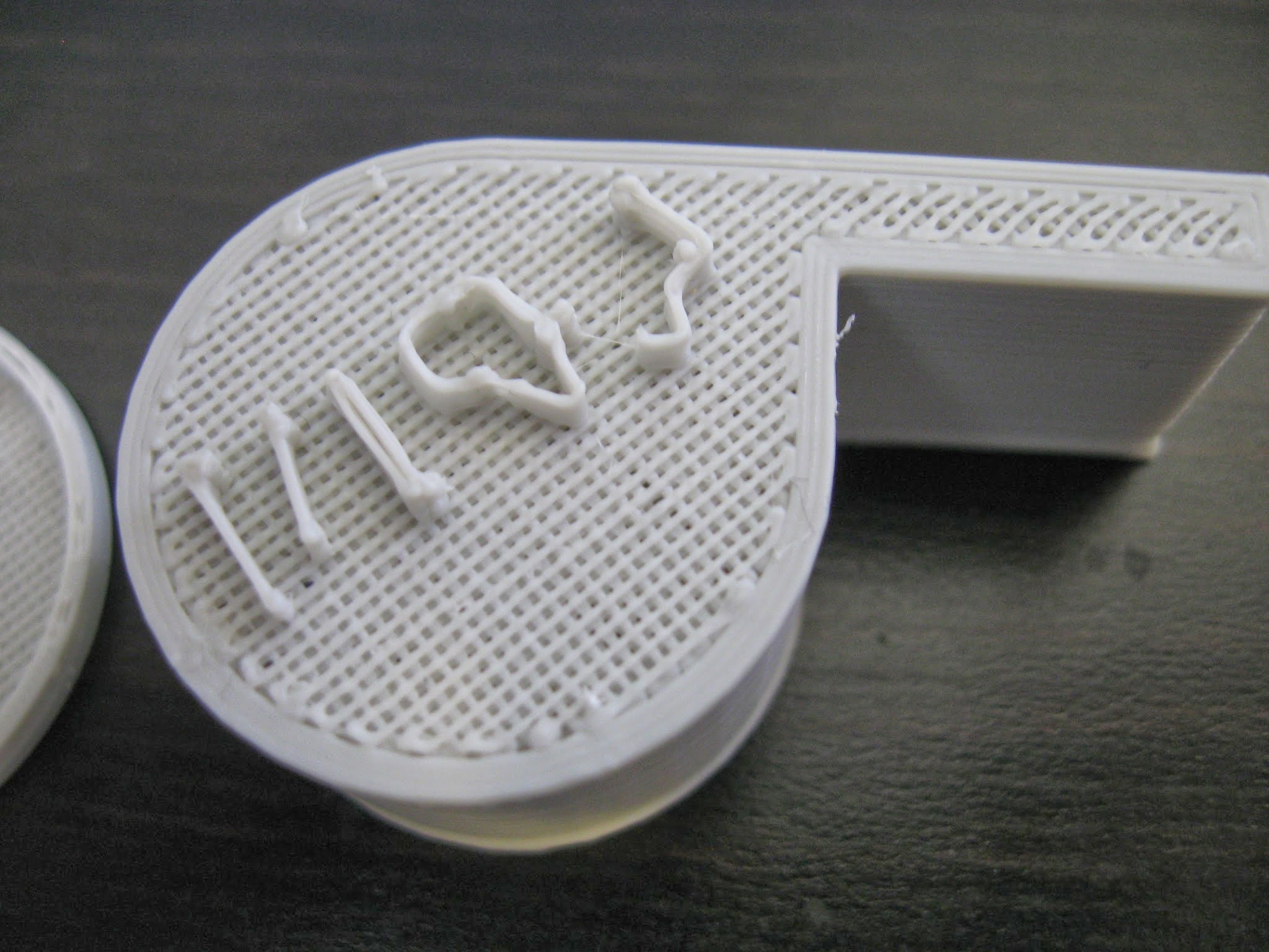

Hi, I’m using Slic3r and RepRap Prusa i3 with J-Head 0.5mm nozzle, but my top layers are not solid. I have set Solid layers = 4 in Horizontall shell section and Top/bottom fill pattern to rectilinear, but my top layers still lookd as you can see on photo (bottom layers are absolutely solid and ok). What should I do or change to have solid top layers? I tried a lot of objects, but still same problem.

@John_Ridley agreed, it does look a little intense to be caused by just a miscalibrated extruder, but volume errors can accumulate over the layers if the extruded plastic is fairly liquid and keeps filling the gaps in the layer below instead of building up the current one.

@John_Ridley I had weird things like that happen during calibration when I forgot to issue G92 E0 in between changing the E steps per mm. I think marlin would recompute it’s notion of how far it had traveled along E so far, so it had it’s own notion of how many mm needed to be extruded when told to do 100mm
