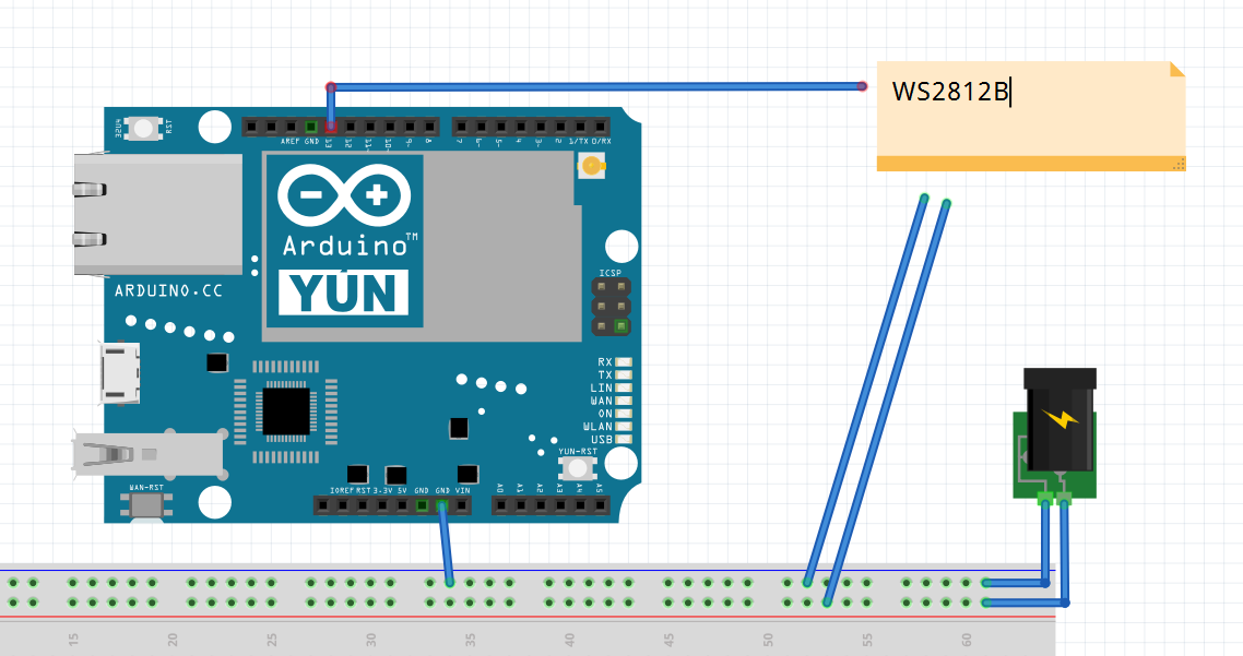

Hi, I'm using the WS2812B Led strip (30 LEDS) on the Arduino Yun,
Hi, I’m using the WS2812B Led strip (30 LEDS) on the Arduino Yun, but it is not working. I tried the same code on the Arduino Uno and it works perfect. Does anyone know if I have to do something extra on the Yun? FastLed version 3.1.0 and Arduino IDE 1.6.8. I tried pin 6, 7 and 13. Power supply is 5VDC 3A and the Arduino Yun gets powered via USB for now.

Yes, the led on pin 13 does blink. I don’t think there is a way to split the Linux from the Arduino part, but they do run on two separate chips. That’s what the bridge library is for. I don’t see/know a reason why this shouldn’t work. The led strip shows nothing at all when using the yun, but works as expected with the uno. I wanted to use the yun to fetch weather data from the Internet and ‘show’ it on the leds.

Hi, sorry for the late reply, I got a secondary yun now and it still won’t work. I tried Arduino IDE 1.5.4 with the latest fastled, but still nothing… I’m running out of ideas here…
The weird thing is that I put the same code on the yun and the uno, connected them to two LEDS and they both seem to give out the same signal (hard to say if it’s exactly the same without a scop), but it looks as if they run at two slightly different speeds… Any way to fix this?
