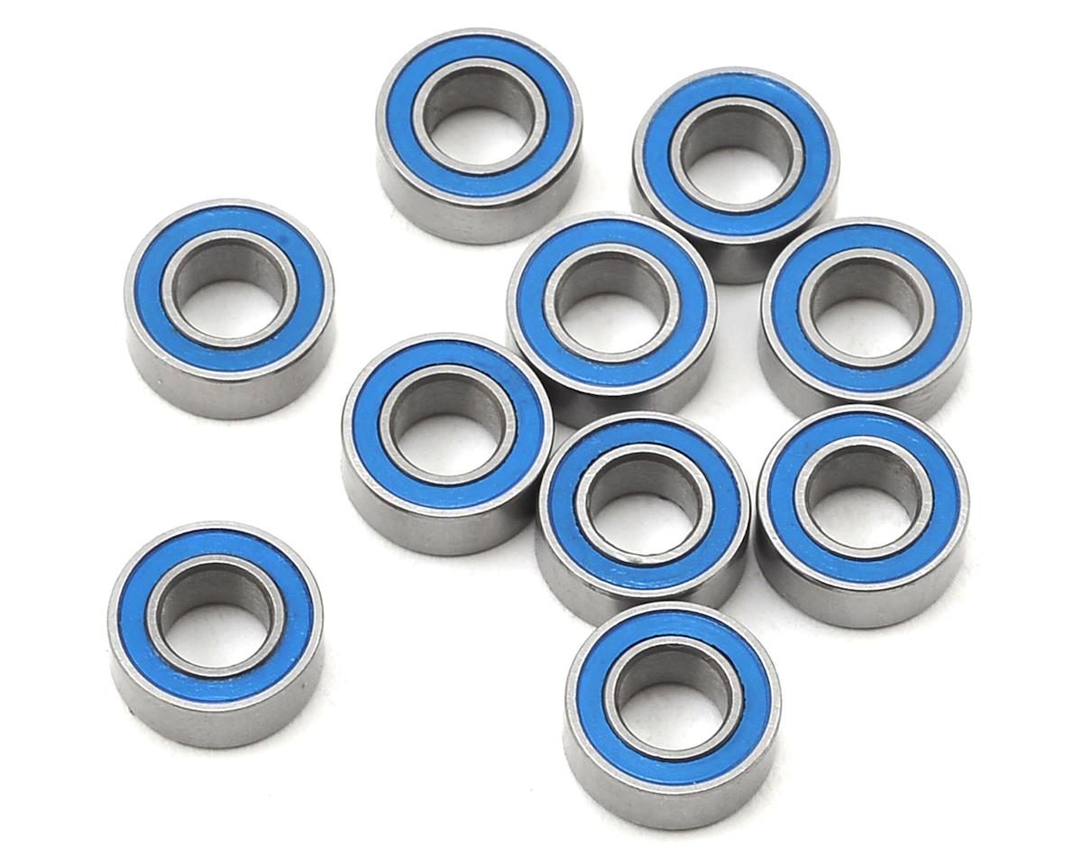

Hi!  Is my bearing list totally wrong or will these work ? :) :
Hi!
Is my bearing list totally wrong or will these work ? :slight_smile: :
beerings:
wheels you need 8pcs 4x5x10 (width x inner x outer diameter)
drivetrain you need 6 pcs 4x10x15
and 4 pcs 4x5x10 (when u use hsp-diffs s.b.)
steering you need 4pcs 4x6x12:
i posted my BOM before (when using hsp-diffs):
