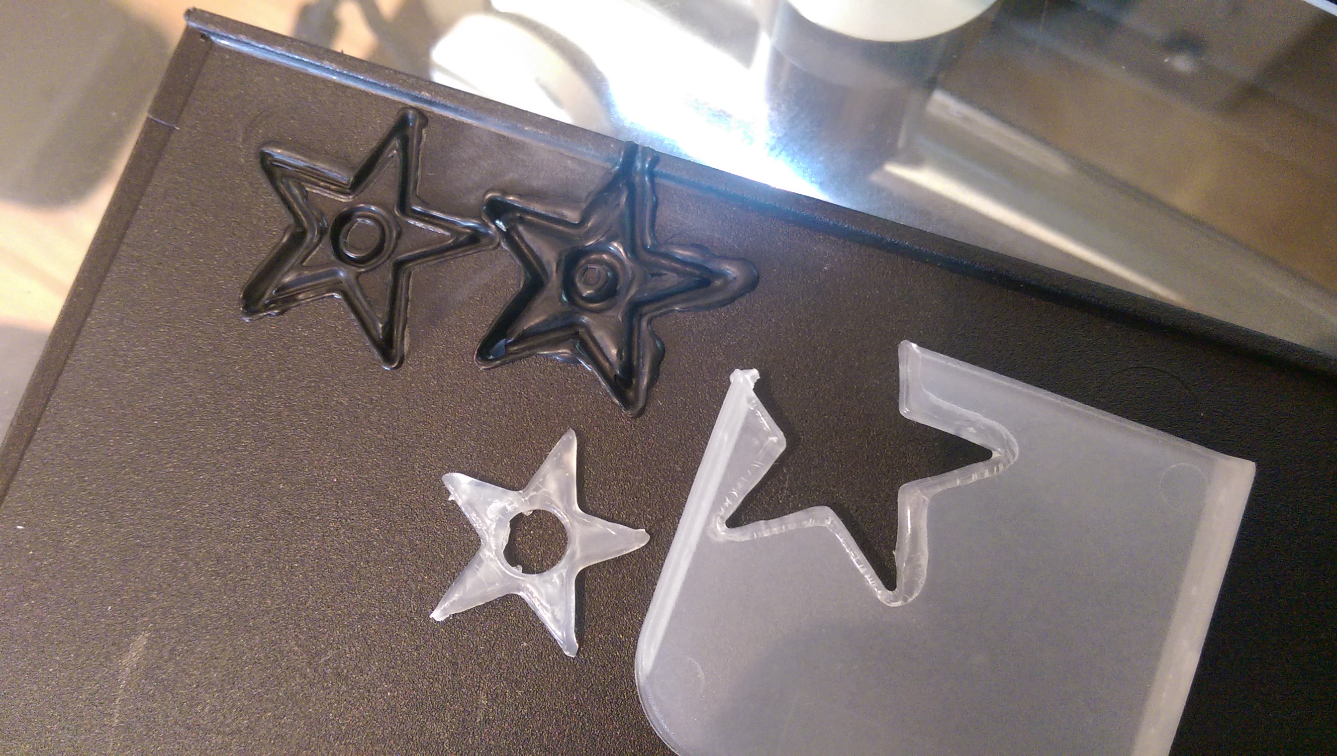

Hi, is there any way to visually identify the type of plastic I am
Hi, is there any way to visually identify the type of plastic I am using under the laser, I have heard people say stay away from PVC but if its not marked how do you know?
I ask that question because I’ve just got my cheapo 40w Chinese laser set up and I’m trying to find out what it can do. The picture is of two pieces of 2 or 3mm thick plastic (dont know what type) separators used in tool boxes. Tried with the same power and speed, 5mm/s, to cut a star but with not very good results. I will not be testing with the same stuff again, it was the first thing I could find and didnt think about the material to start with.
The black took over 10 passes at /possibly/ 3mA, the dial is so twitchy that I hardly touch it and it jumps three to five points on its own. The white took two passes on the same setting and cut out the shape but obviously not very neatly.
I have aligned as best I can, brought the top of the material as close to the focus point as I can and have some air assist from an airbrush pump aimed at the focus point.
Any warnings or advice to better cut shapes from plastic?
Thanks,
Peter
The laser will not fire reliably at 3mA. Turn it up to 6 or 7mA and you will get much better results.
acrylic will cut cleanly. PVC , Polyethylene ect… will melt. Like the plastic in your photo. Some can give of poisonous and corrosive gasses

I went from this test to some 1mm foam sheet. turned the power down further but the cut seemed pretty wide. Probably melt rather than cut. I have a Mr Beam (kickstarter project) with a 1W laser for lighter stuff.

PVC Burns ( forms a black film that crazes when hit with a torch, Polypro waters (leaves streaks on the surface, and polyethylene melts and smells like a candle.
PVC is noticably heavier then the other 2, and sinks while the other 2 float.
PVC is harder and ‘dry’ when scratched by dragging a knife along an edge, PE and PP are soft and malleable when scraped.
A piece of PVC welding will stay bent if bent, the others spring back.
