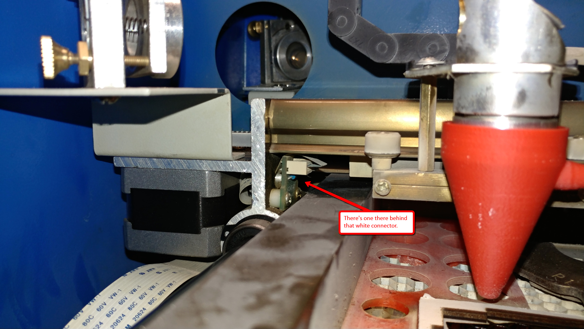

Clean the optical sensor under the gantry, on the left side. For me, a few short blasts with air was enough. It’s also possible that the sensor has failed in which case you’ll have to replace it. But start with cleaning first.
can you post picture where actually it is and how it looks? did not even know about such sensor…
Look behind the motor on the left side, there’s a sensor behind it, and there’s another underneath it.
Oh, that worked! Googled and find pics, cleaned, now ok. Thanks, gracias, merci!
