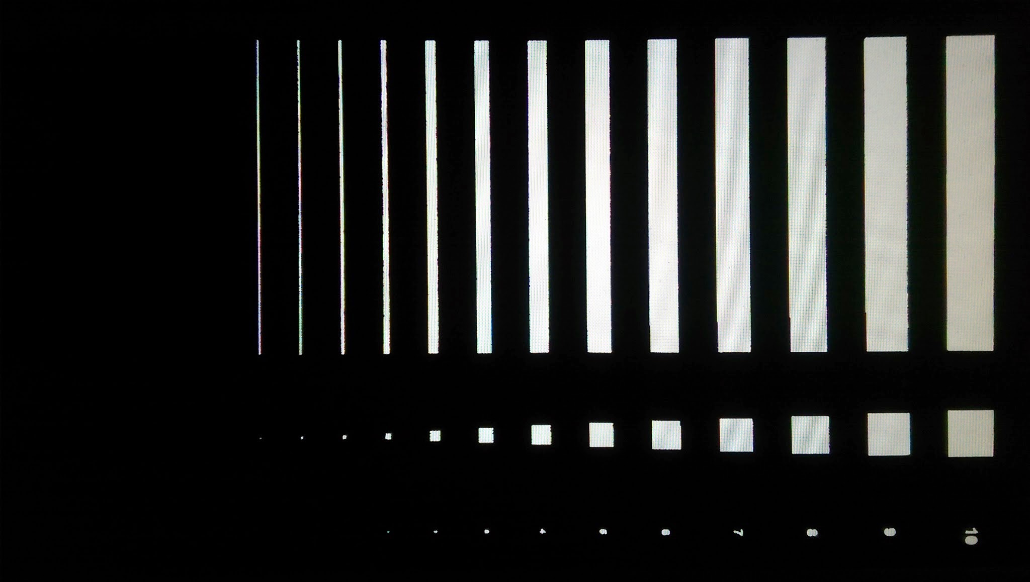

Hi. I've had the laser for a few days now so I've just done
Hi. I’ve had the laser for a few days now so I’ve just done a quick resolution test. The bars and boxes are 10, 9, 8, 7, 6, 5, 4, 3, 2, 1, 0.5, 0.25 and 0.1mm. I can’t see much difference between the 0.25 and 0.1mm. It’s lightweight card (about 160gsm) and laser settings were 6mA power and 34mm/s speed.
[For those that work in imperial: 0.394, 0.354, 0.315, 0.276, 0.236, 0.197, 0.157, 0.118, 0.079, 0.039, 0.0197, 0.0098, 0.0039 inches]
