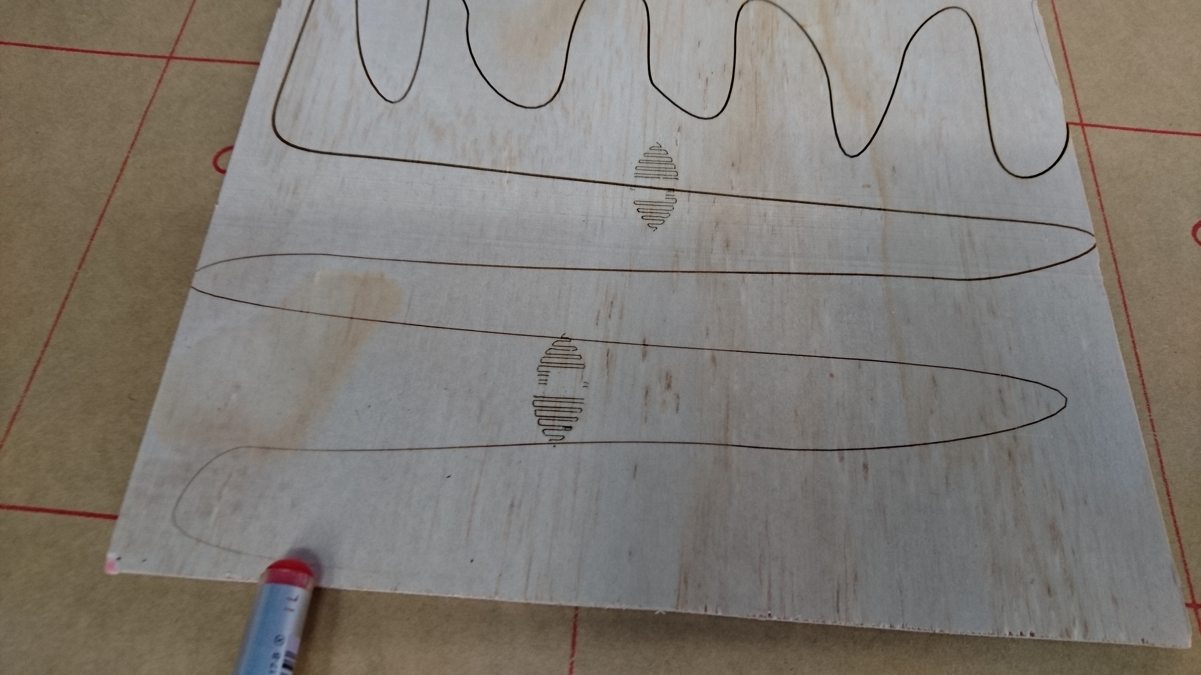

When cutting a continuous line, the machine will start quite strong, but the laser strength will continually decline as the line is being cut. At the beginning of the line, the wood was cut through, by the end of a line the laser hadn’t even marked the plywood.

I’m confident that it isn’t the alignment or focus. I tested this by cutting a circle. If it was a focus/alignment issue then the beginning and end of the circle would be the same cut strength. Instead the start of the circle is strong, the end of the circle is not even marked on the wood.
