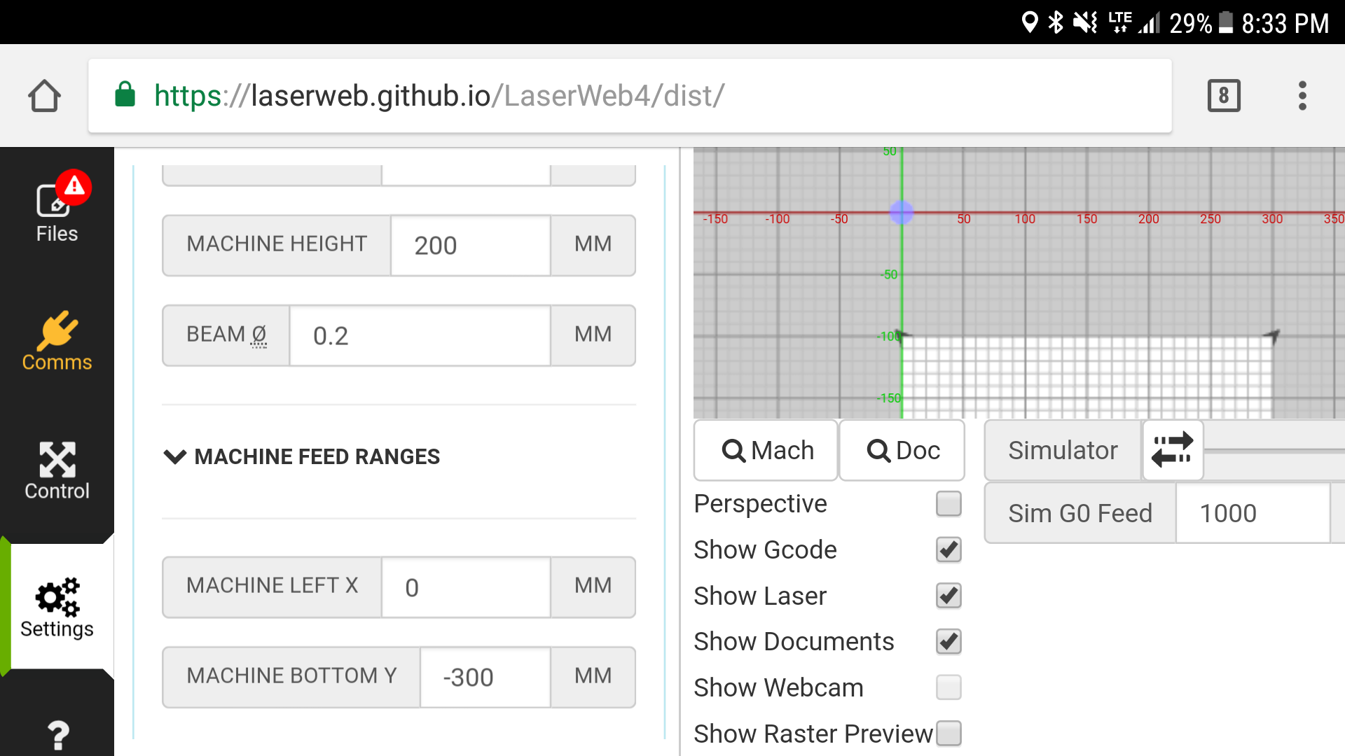

Hi laserweb community! I downloaded LW4 and love the interface and usability, but i need help with one thing, the LW4 orientation is bottom left, but my machine is top left, is there a way to change the 0,0 so the two align? I would like to use the top left as 0,0 because that is where the beam comes out of the machine, any help is greatly appreciated!
@Baxter_Smith welcome. Have you first set up your firmware to home too left? Are you on GRBL or Smoothie?
Also please download the latest version at https://github.com/LaserWeb/LaserWeb4-Binaries/
@Ariel_Yahni_UniKpty thanks! using Smoothie with the C3D mini board. M115 found top left and G28.2 zeros home there but the display still shows home as 0,0 bottom left, i could switch the y end stop to the bottom of the machine but wanted to keep top left as 0,0 for proximity laser beam
Get the lastest version please. You will notice 4 arrows on the grid when you do
The go to Settings/Machine and type -200 on the Y axis and test. @Todd_Fleming is this correct? I haven’t tested it
@Ariel_Yahni_UniKpty yes, assuming Y range on his machine is 300mm.
@Todd_Fleming thanks brain f#$+t
@Ariel_Yahni_UniKpty @Todd_Fleming that worked! thank you both so much, i can now laser cut from the top left! and i downloaded the latest version, cant wait to play more with this awesome tool
