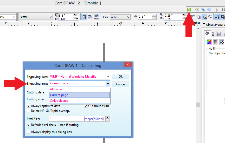

I think I found it. Click the green button in the CorelLaser control panel. That opens CorelLaser settings (different than general laser settings). Then Engraving Area.
Yes, you want to have “only selected”. Glad you figured it out.
Oh that was great thanks it worked a treat. Thanks for the help both of you
