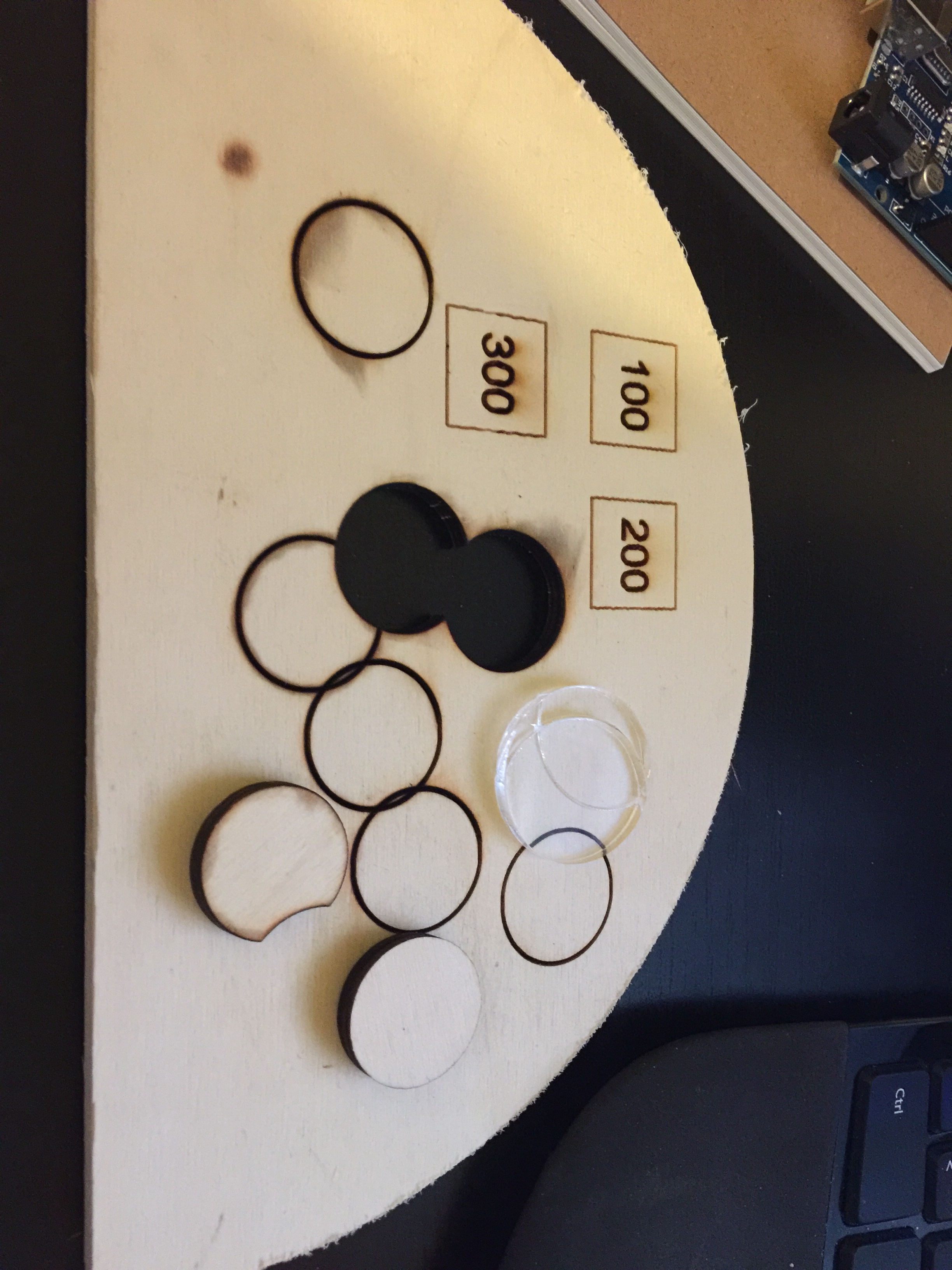

my machine arrived on Friday, and after testing it seems everything works as i expected.

I could cut acrylic (3mm) and plywood(5mm) in two passes, not bad at all, for my first attempt.

Well then that’s good because on mine I need 4 passes on a 5 mm ply. Maybe it’s the ply I’m using. Congrats for the first successful cut
I cut 3mm acrylic in one pass at 8mm/sec at 12mA. I’m in the same boat of slowing upgrading my K40. At the moment i’ve only redone the bed… but making a wish list for all the other stuff.
@Cesar_Tolentino What speed are you using? i cut acrylic 15mm/sec and plywood 12mm/sec, two passes both. The only issue with the plywood is that i haven´t installed the new head with air assistant yet, and in the second pass, i get flames, and it´s a little bit scary :), but once is finished the flames gone.
