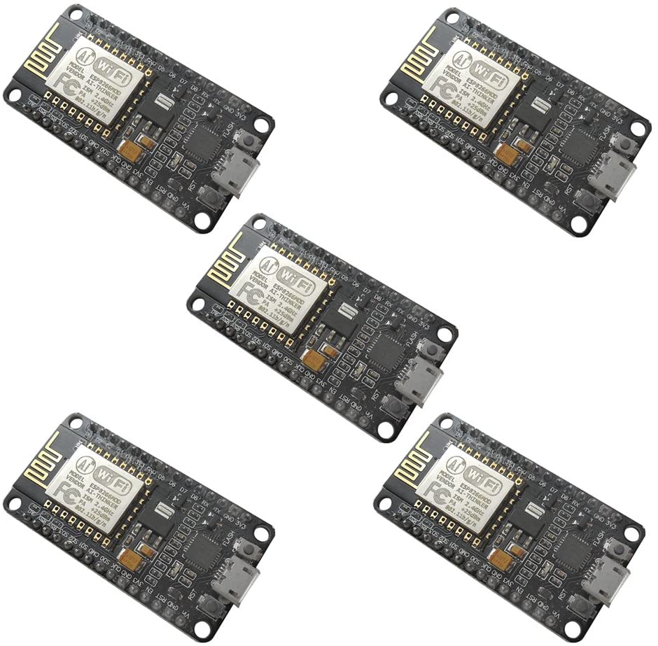

I am using these:
They appear to be ESP8266s rather than ESP12s.
ESP12s are the next generation and are still much more expensive, and more powerful.
you many be thinking about the ESP32, the 12E is pretty standard, more RAM and clocks.
