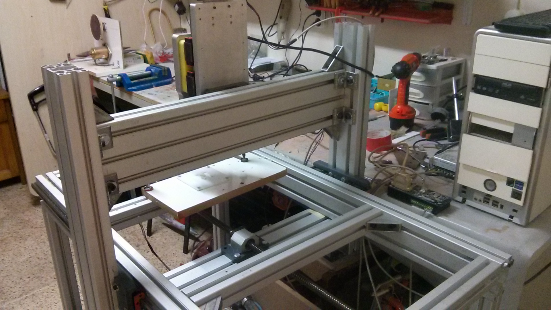

first post here. I am building a router with aluminum profiles. I got lots of problems with my build. first of all Y axis is vibrating wildy when moving over 1000mm/m. What can it be? I suspect the lovejoy couplers. And I cannot make X and Y square. the angle between x and y is changing when i move Y axis. any ideas? thanks.

Than you could try to make the Y stepper holder more solid. I see you made it from metal sheet. What bearings is on the other side ? Is there any backlash on a ballscrew bearing ??
So you are using linear slides… what are those grey things between the slide carriage and the vertically oriented aluminum extrusions supporting the X/Z axis platform? I’m wondering if there is much given/catch there when you move it by hand? If there is any wiggle, it will most likely oscillate during movement given that you have a top heavy setup. Suggestion would be to power off, manually move the platform along the y axis and feel for any slight change in pressure/smoothness/rigidity, and tweak/tighten. When you move it, move it with force applied from the underside beam to mimmick the force that would be applied by the ball screw drive.

@Stepan_Zalsky I used bf12/bk12 on y axis. and yes stepper holder is 2mm bent sheet. it is vibrating too.
@Wing_Wong I milled the grey parts. i used those parts to fix the carriage to vertical oriented alu. extrusions. when i force gantry sides to opposite side by hand there is 1-2mm wiggle occurs. I will try what u said about tweaking.
