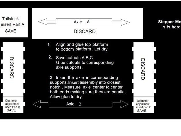

There was a member on here a while back who cut the main parts out of thin plywood with his laser and built a fairly simple one. He obtained a similar spec’d stepper motor and wired it in place of the Y axis. His photos showed good results using it. Unfortunately he closed his account on this forum and deleted all his posts here and on thingiverse. One of the current members here may have downloaded the plans and info when it was available and be willing to pass it on?
yep it was alreadygone, he change of name, but didn’t reappear in community list. so the post posts disappear too. but the photos was still there in the photo sections before disappearing recently too.
the last one you can see is in my pdf

Here is alreadygones files, I uploaded them to thigiverse.
