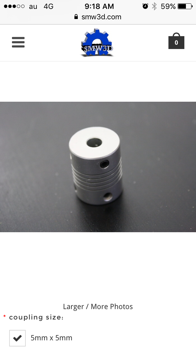

Can you let me know what size coupler I need for the R7 ball screws?
My coupler isn’t quite catching the ball screw correctly and is bending to one side. This causes the call screw to rotate with a wobble.
Hi Kevin, your using ball screws or the stock ACME screws? The stepper motor shaft is 6.35mm and the ACME is an 8mm so they ship with a 6.35 x 8
Ah! ACME screws I guess since that is what it came with. Thanks a lot for the reply.
