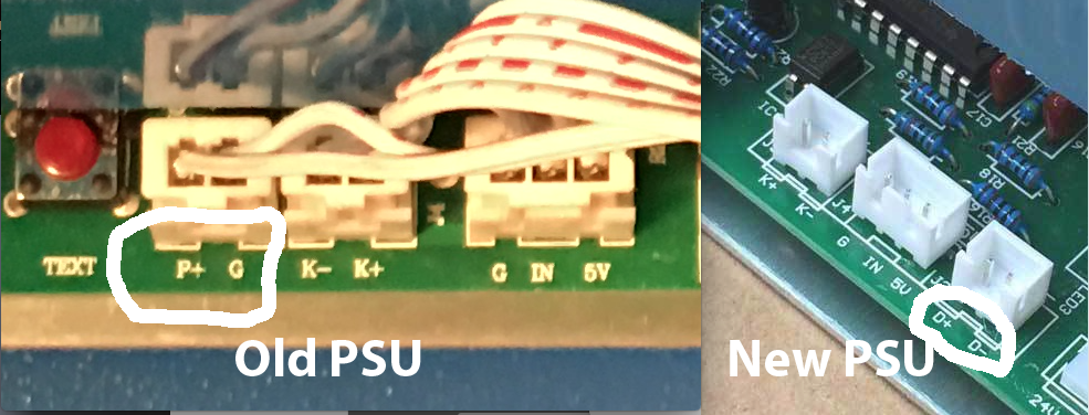

I have a question. The PSU on my K40 died a few months ago and I FINALLY gave up on getting a replacement from my eBay seller and bought one. All the connections are direct mapping except for one pair. I wanted to consult with the community before I try ANYTHING to see if this is “OK”. If not I will send it back and purchase a different one. I have included a picture that clearly defines the question. Are the P+ & G connections on the OLD PSU the same as the D+ & D- connections on the new one? Thoughts?
Im sorry I cant offer much help on that front, but I do notice that the K- and K+ connectors are reversed on the 2 boards. K- is on the left on your old PSU and on the right on the new one. Looks like the tab on the connector will let you connect it incorrectly as well. You probably have to switch the wires around in the connector before attaching that one.
On your OLD Power Supply:
The P+ and G are your Laser enable switch (“LASER SWITCH” on the K40 panel)
K- and K+ are the “LASER TEST” switch and “G, IN, 5V” is the Power setting pot on a K40 (In takes 0-5volt signal to set power %.)
Pin #4 of the power supply connector is the “Fire” signal (5v pulse)
So…
On your NEW Power Supply:
The new supply has the 1st connectors (Laser enable and level pot), so you’re all good there,
I can’t see the power connector on the new supply, but if it matches the old one, it should be pinned as follows:
1 - 24V, 2 - Gnd, 3 - 5V, 4 - Fire signal.
Check your new supply and confirm that matches.
All else being equal, all that’s left, is the D+ and D- lines. which I’d have to bet, if I were a betting sort, that they are indeed the Laser Enable loop.
The Laser Enable loop often has more than just a enable button in the circuit, it also is the place where door interlocks, water flow switch and that sort of thing go. ALL must be closed for the Laser Fire signal to actually fire the laser.
So, connect the wires from P+ & G to D+ & D-, and she should be all good. Polarity doesn’t matter, despite the designations.
This assumes the fire command is indeed pin 4 of the new power supply’s power out connector and the 24v, Ground and 5V pins match as well. That’s critical.
1 -24v 2 - Gnd 3 - 5v 4 - Fire
Good luck!
Scott
