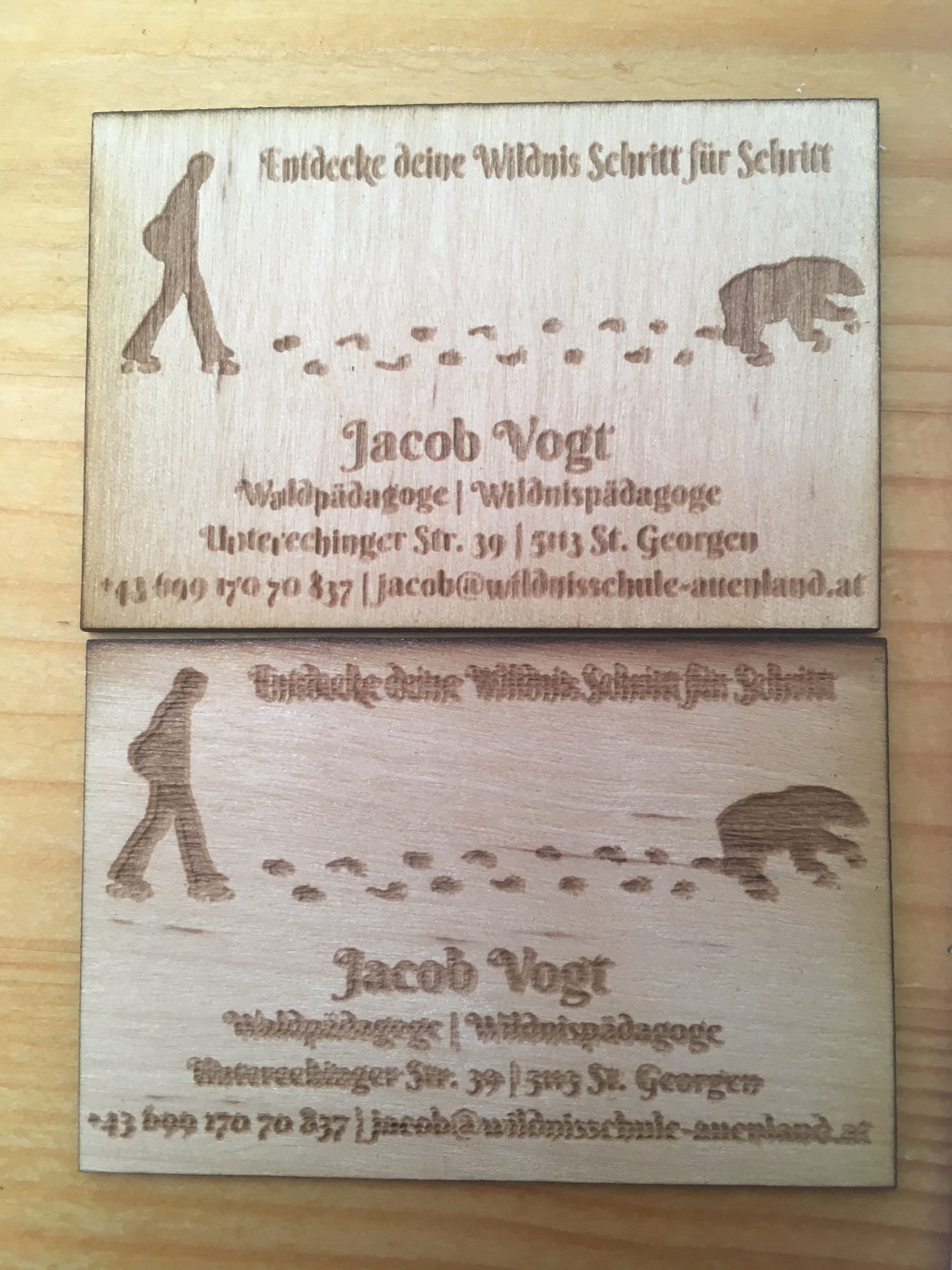

doese anybody of you have any experience with this problem? Short ago I aligned my Laser cause it was completly off. Everything is perfect in line now I thought.
BUT The Raster Engravings got blury.
I found out how it happens:
When the Laser goes This way > It engraves over the allready engraved
When the Laser goes this way < It engraves one step lower
So this direction > always goes over an area that < direction always has been on.
Thats why on the lower picture it looks loke it got engraved twice.
Interestingly this effect does not happen in the upper left corner and is the worst if the laser is far ot on the right.
Does anyone of you have an Idea how to fix that?
