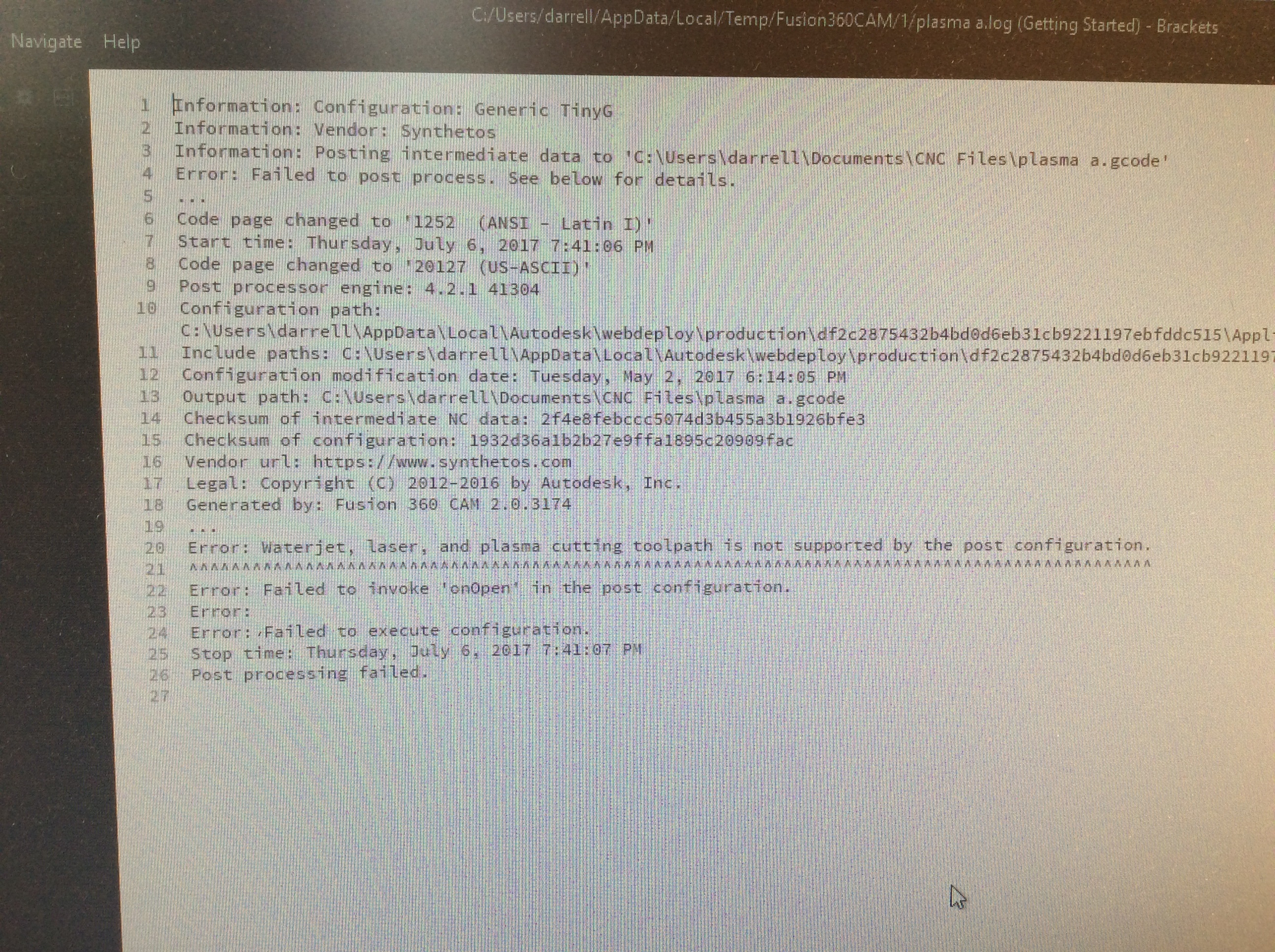

i’m using an ox build with tinyg fusion and chilipeppr. and milling works great
i now want to switch to plasma but when i post processing i get failed to invoke onopen in post configuration. and i’m not sure how to solve this problem any help is appreciated thankyou
I have found fusion 360 to not work with the laser or plasma post processor because it requires tool offsets. The way I get around it is to generate a milling path that just turns on and off the spindle to toggle a laser and possibly your plasma

To me, plasma cutting is all about how you toggle your plasma cutter on or off. If it’s just done from the spindle on/off then you can pretty much use any CAM software. Fusion 360 is my favorite. I’ve never done plasma cutting though.
