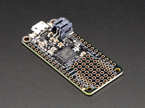

Hi there I am getting a bunch of problems running FastLED on this board.
Hi there I am getting a bunch of problems running FastLED on this board. Can anybody help? Yes I am giving enough power. I have got only 2 sample codes to work. But nothing else. Just a bunch of random colors on strip.

This Feather board is 3.3V correct? Curious, are you using a level shifter (74HCT245)?
Yes Feather’s are 3.3V logic.
