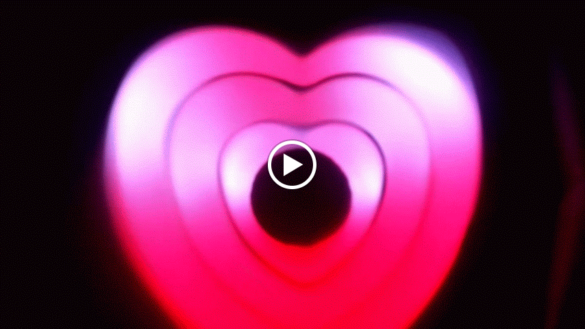

Hi there,
I’m working for the first time with hi density leds (144led/m neopixels).
With fast animations all is good, but with slow moves it doesn’t look very well
I really see the pixels going on and off, so with the diffuser it seems to flash.
I’ve tried using @Mark_Kriegsman 's anti-aliasing algorithm but that doesn’t change much.
Any ideas on how to get this flashing removed ?
Sorry, the flashing doesn’t appear well on the video but I really see it through my eyes
