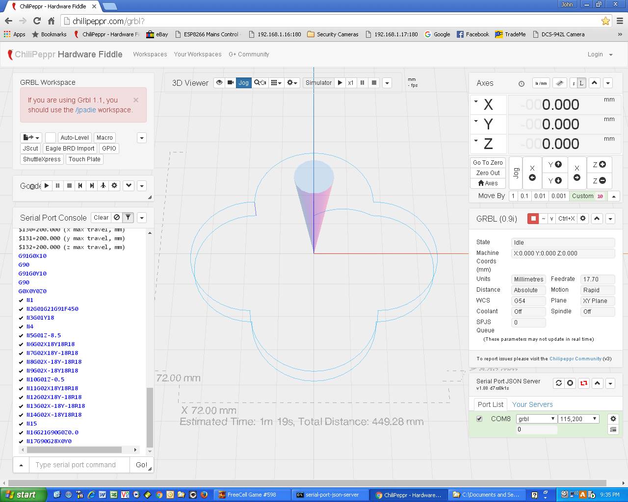

I’ve included a couple of screen shots that show the strange things that were happening.
The 3D viewer was displaying my G-Code file, which was a simple circle 36mm in diameter, as a four- sided semicircle totalling 72mm across. When I ran the 3D Simulator, it would appear to ‘trace out’ the correct path of the file but wouldn’t display it.
When, as a test, I manually moved the X axis by 10mm the X, Y, Z indicators on the upper right, showed correct, but the Machine-Coords (lower down), showed as inches.
I checked the parameter $13 and it was set to 1 (inches) so I changed it to 0.

I think the tracing of the arcs is a known limitation of the viewer. It doesn’t effect the milling.
My workspace has issues with units in certain edge cases. Provided that you have gcode loaded and a driver connected then it should work fine and will mirror the gcode G20/21 directive.
If you don’t have any gcode loaded then you may find issues with units. The work around is to force the issue by sending G20/21 through the serial console.
