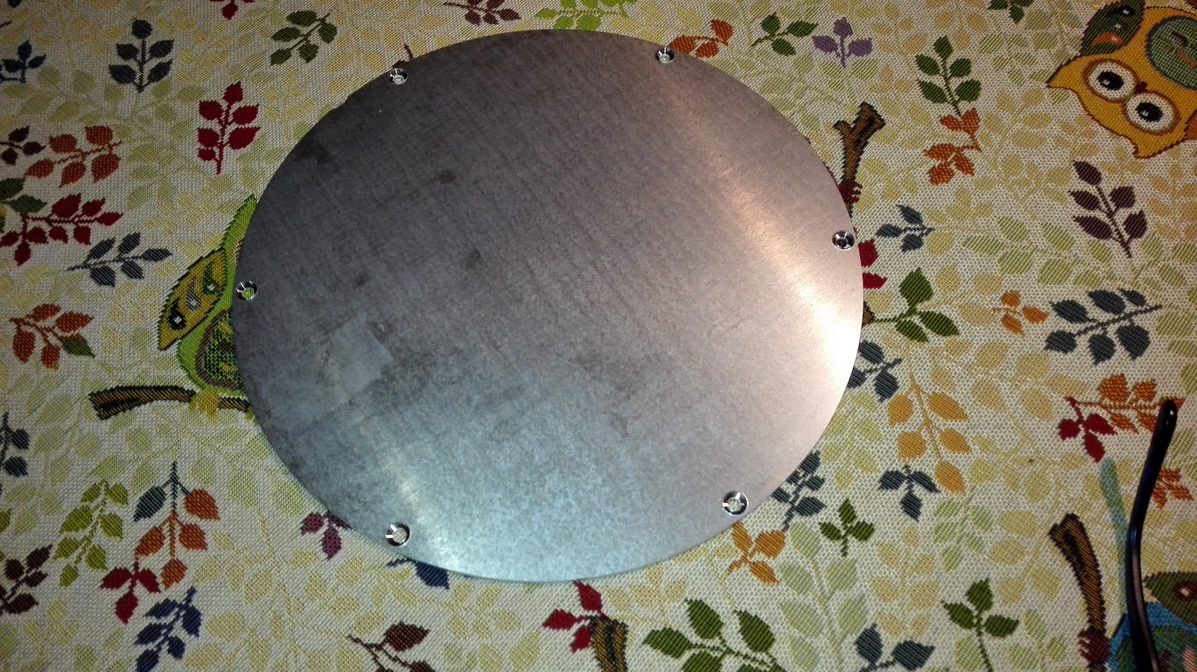

thank you all for the valuable advice about my heated bed in the previous post; unfortunately I didn’t solve my problem, so I’m trying to solve it again working on the root of the problem; I have a aluminum heated bed too, adn I decided to mount it in replace of other one; and here is the questions :
  • does ABS stick well on aluminum, or may be do I encounter the same problem? I think hte aluminum surface will be easily more hot than using the old one, but I don’t know if a simple increase of temperature does solve my problem
  • I can’t figure out how and where I can mount the thermystor; the only thing I can think is to put it on the aluminum face, but obviously on the edge of the plate; will it be enough?

On smooth, and typically non-sticky surfaces like aluminium or glass I have experienced that hairspray or 3DLac (basically the same as hairspray, just without scents and parfume) performs really well with ABS.
Drill a hole for the thermistor in the middle. Then cement it in or glue it in with silicone rubber
Edit: oh ups thats a alupcb sry. Either there is a hole or pads fora smd thermistor
