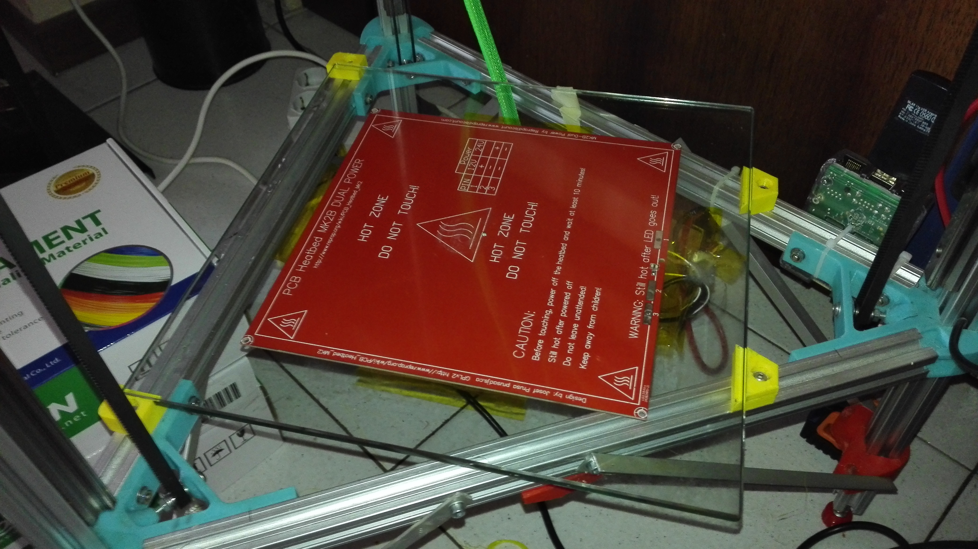

Hi There, this is my 3d printer (a self-made Kossel type) heated bed,
Hi There, this is my 3d printer (a self-made Kossel type) heated bed, a simple 6 mm glass; I have a strong adhesiveness with PLA using a common hair spray, but it doesn’t work fine with ABS I’m trying to use; I heat the bed to 90°C for ABS; I notice it’s useless tying more warm, the temperature doesn’t rise too much near 100°C, perhaps I have to insulate the bottom part of the bed. SO the question is : what may I use to get a better adhesiveness? simple little pieces detach from the bed on its edges. thanks and bye
Maybe having the glass blasted with a very fine oxide would help or find frosted glass give something the abs to key too
ABS juice. Acetone with pieces of abs. Spray onto the bed. Or use capton tape on the glass.
ABS can be tricky (more so without a heated chamber) … it is a picky material. You can even get detachment due to minor warping of the first layer. One thing to try is ABS Juice. You take ABS shavings/scraps and dissolve them in Acetone and use that as a coating for the first layer. Be careful removing it from the bed as it can become well stuck. On the slicer side you can try adding ‘mouse ears’ to the first layer as well.

Interestingly, no one has suggested using a smaller glass piece yet. This looks like a 5mm thick piece, which will act as a huge heatsink around the edged of the heated area, pulling out a lot of heat probably even from the very center of the bed. ABS works best above 110°C bed temperature, the most reliable store-bought adhesion solution for it is glue stick in my experience.
Also use an insulation below the heater. get some cork and put it directly below the heater. That will direct all heat up.

You might also need to insulate the underside of the bed. I use a piece of cardboard with aluminium tape on both sides, nophead style. Take care not to close off the cardboard edges, as the air is the insulator here.
