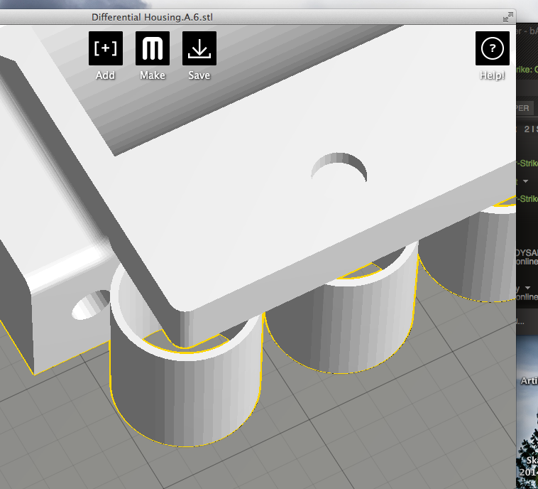

Hi, think i'm having problems slicing Differential Housing.A.6 .
Hi, think i’m having problems slicing Differential Housing.A.6 .
This support won’t do any good on the edge i here guess. Is A.6 the latest version?
@David_Baron Hold on, I have redone this and am now using the “wishbone holder” as support instead! I’ll upload it in a few…
@David_Baron https://grabcad.com/library/openrc-1-10-3d-printable-rc-truggy/files/STL´s%20for%203D%20printing
Thx for the update, have you succesfully printed this stl? Don’t know if it’s intended, but seems to be a gap of about 1/4mm between the “housing bottom” and the wishbone holder.
@David_Baron Yes i have printed a few and the gap is intentional. Without the gap you won’t be able to separate the parts.
@Daniel_Noree Good point, didn’t realize it was going to be separated after, my first print of the Truggy. But the diffhouses will be printed monday, 24h print on three of the rims on the printbed atm :wink:
