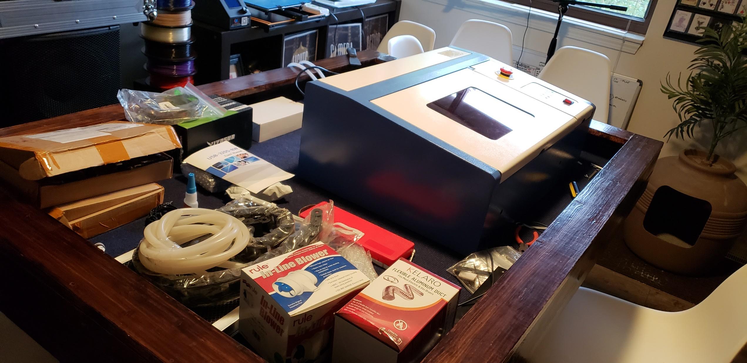

@Mario_Gayoso my setup so far. I still have some work to do, but I’m cutting parts.

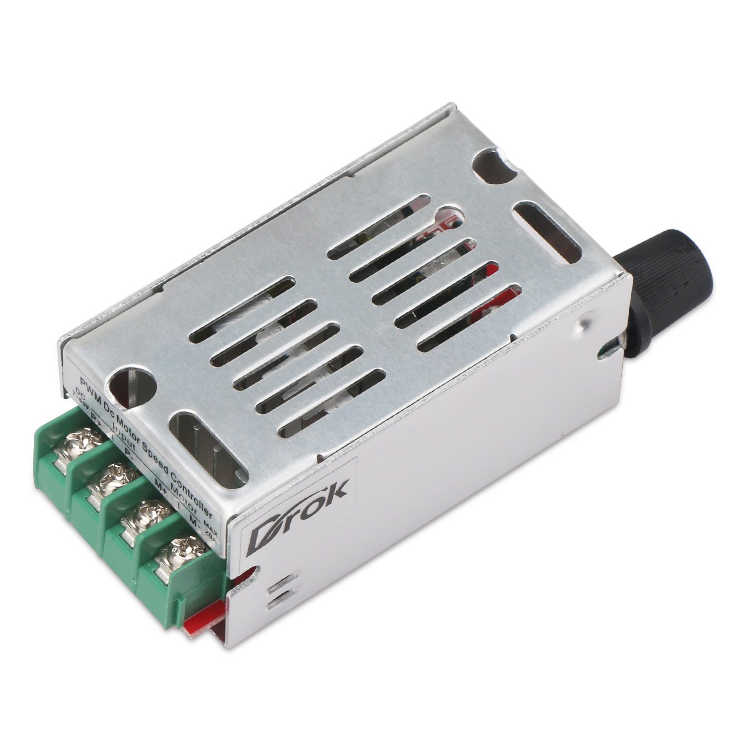

heres the upgrade list you asked about on youtube. I think just about everything i did is in it.
12 volt speed controller

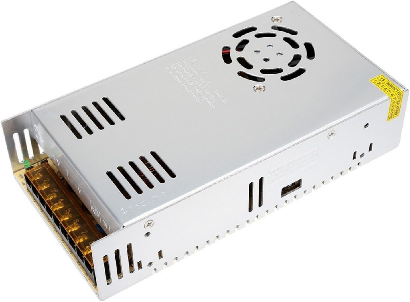

24 volt 15 amp power supply

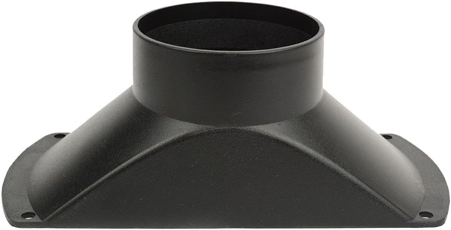

Air extraction Hood

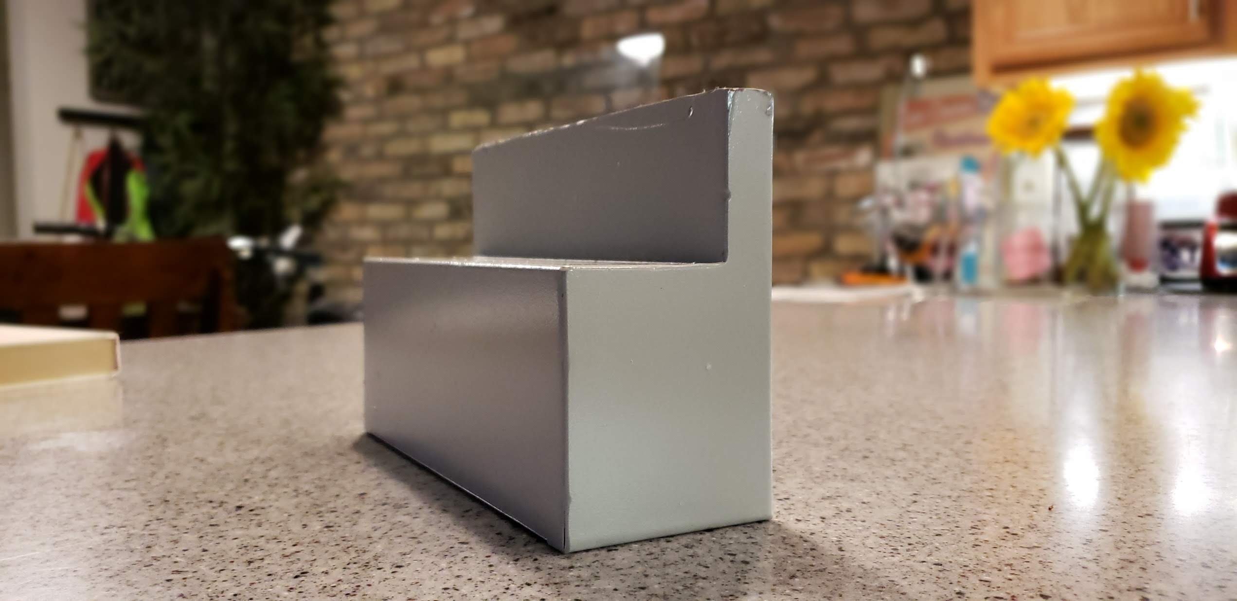

@Mario_Gayoso the aluminum plate, the honeycomb grid, and the 24volt power supply are for the z table. You will also need 1” square tube 1/16” thick if you get the holes mods z table. Give Randy a call or email about the z table he can walk you through it. It’s not hard to build but did take me a few hours. That being said this isn’t the first time I’ve messed with cnc machines.
I wouldn’t get the grid you looked at if you get that z table. The overall size may not be correct.

@Adam_Hied I will post everything I got! I will need your help man!! Haha I’m thinking about that table you mention. I got the honeycomb bed but maybe I should get the z table.i went all in and got the chiller too. I also cut the exhaust and I did a pretty decent job.
@Adam_Hied this is how I cut the duct
