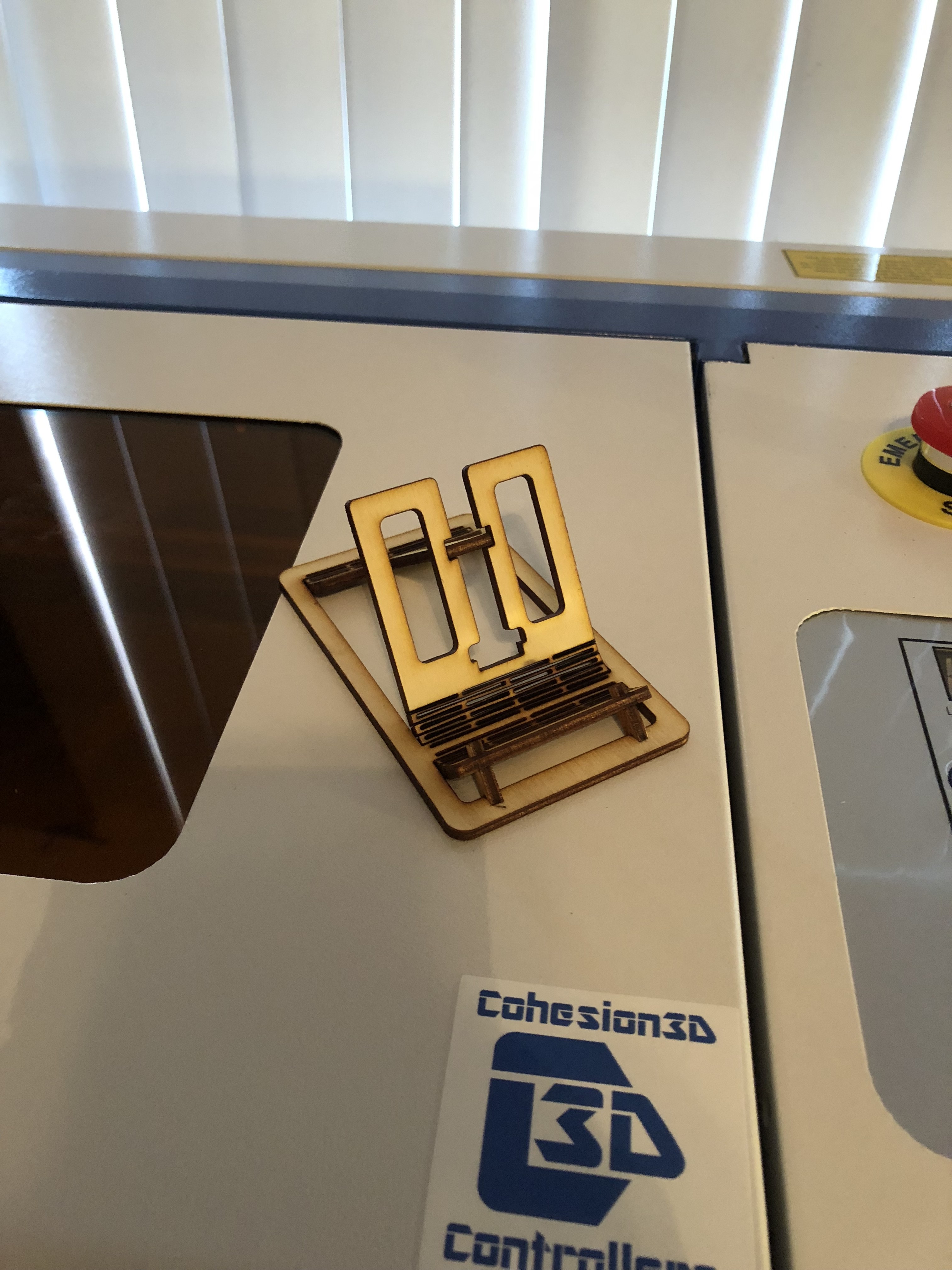

First cut on the setup. I still need to fine tune the power and speed, but it’s not too bad
