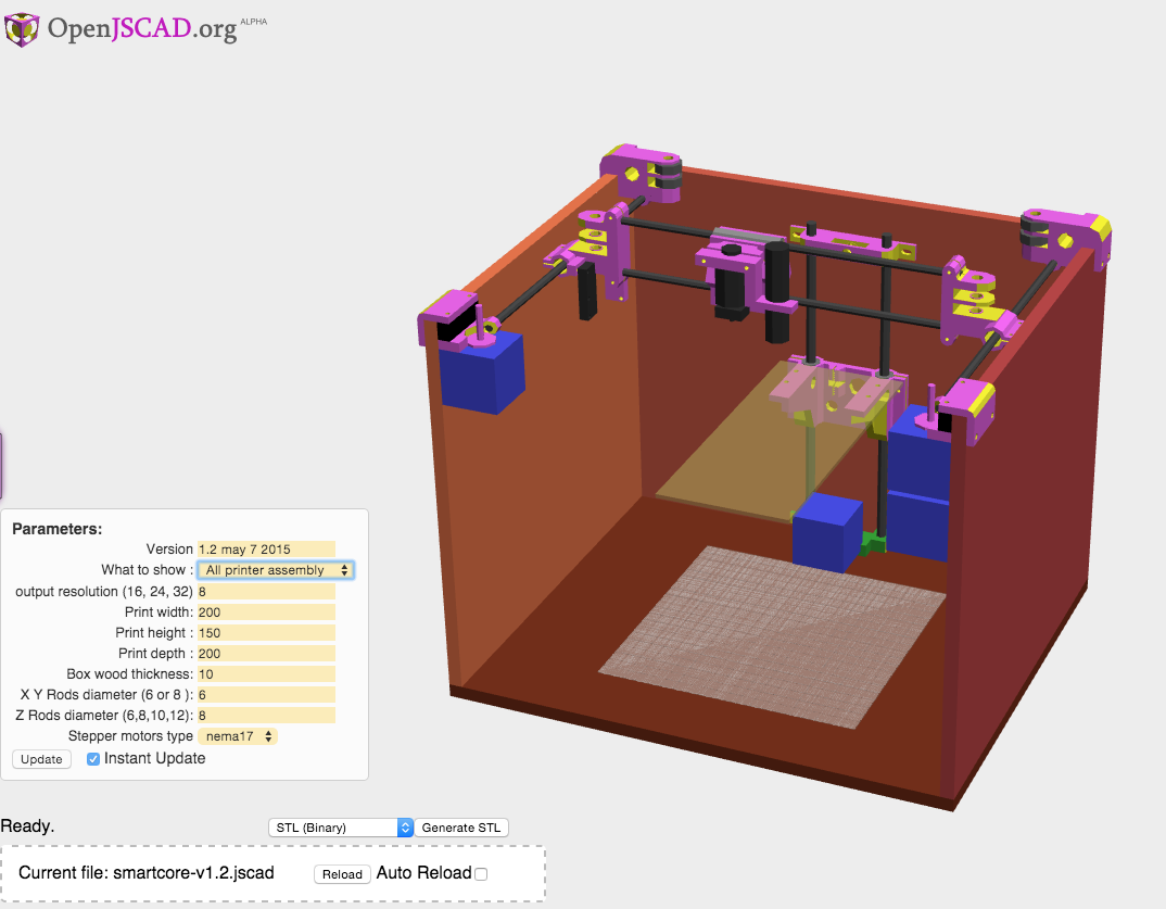

Hi to all, just to say the sources for the smartrapcore are now at
Hi to all, just to say the sources for the smartrapcore are now at 1.2 on github , youmagine and thingiverse .
what’s new ?
  • bearingsXY : now fix on the side ,more easy to build and far more solid on the Y rod ( it was breaking too easy)
  • Head : new one piece part , was problem with assembly. when you fix, parts are not aligned and bearings become hard. was not stable enough
  • new inductive support : more solid and lower
  • new slideY : far more solid, Xrods are further away , we have now an iso assembly (allmost)
  • new Zslide : more solid, bigger, we fix the plank with 4 wood screws . no need to counter drill anymore.
