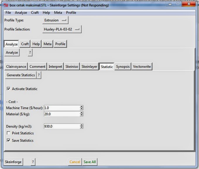

Hi, when I use the Statistics which is part of the Skeinforge Settings,
Hi, when I use the Statistics which is part of the Skeinforge Settings, and then export the Text Document, it always shows 0.0 $ in the Material Cost, how do I fix it? Thank you.

If I had to guess what the problem was, I’d say you don’t have the dimension plugin enabled.

To answer the question, the info is generated by the statistics module. It’s documented at http://fabmetheus.crsndoo.com/wiki/index.php/Skeinforge_Statistic . If the Material (cost/kg) and the cost (Machine time/hour) are set to $0, then the print costs will come out zero. They default to $20/kg and $1/hr, but perhaps they’re set to $0 somewhere?

If you look at the other statistics in the screenshots provided, it also says that the length and volume extruded is 0, so that’s why i’m thinking it’s dimension.
Ah , I didn’t see the other screen shot. That is odd. Does the gcode print properly, I wonder…

@Thomas_Sanladerer The image attachments I use with 10x10x10cm box, and previously I was using different different dimensions and are typically smaller, I think that with a dimensions larger then the result will be different, it still 0.
@Laird_Popkin Yes, Gcode it works fine, and I use Slic3r.
Long story short, I have downloaded the file Gcode from this address: http://forums.reprap.org/file.php?12, file = 565, the material cost becomes $ 0.1, I am surprised why be like that! I feel that the problem lies in the Gcode file, as you all say, but I do not know how to fix this …
Very odd. I suspect that @Thomas_Sanladerer is right that there’s something going on with the Dimension module.
