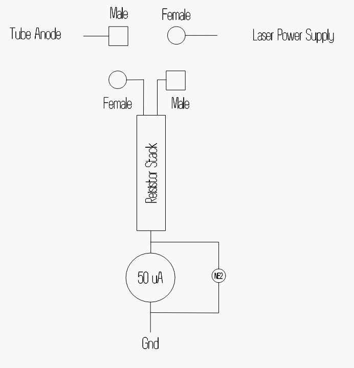

Have planned a high voltage (hv) meter addition to my laser for almost 8 months. The initial problem was procuring the resistors that I needed. The first and second orders never materialized. I needed 600 Mohms of resistance to produce a 50ua (full scale 50ua meter) deflection at 30kv.
It’s quite simply a resistor and a meter to ground. There is a neon across the output to ground in case of a loose or open connection.

This is where the meter connects. The ‘top’ one in the photo is the required ground. The neon is only a safety precaution. If the load is removed (like the meter ‘opens’) you could have full hv on the meter. The reasoning is that over about 90v the neon will conduct.
I would like to mention that the identical connectors were on my 60 watt supply that I purchased from Amazon. Found out differently when I went to install. The inside male/female were of different physical sizes and would not mate. Fortunately l had purchased them as a ‘pair’ so I changed out the lps set, so I can remove the meter and reconnect the lps back to original.
I know you can’t see the difference in size, but trust me, it didn’t work… :frowning:

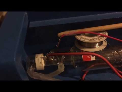

It’s ‘stuck’ in the machine with the 30lb 3m double sided tape. I will make a mount for it.
This is a video (albeit poor) shows it operating. It’s cutting out a meter drill hole template.
Still a working project, but there was some interest. I did have another 30ma meter I stole the face off it, but didn’t put it on this 50ua. Now that I’ve moved I can’t find it, so I have one on order. Just need to figure out how to change the lettering on the bottom from ma to kv…

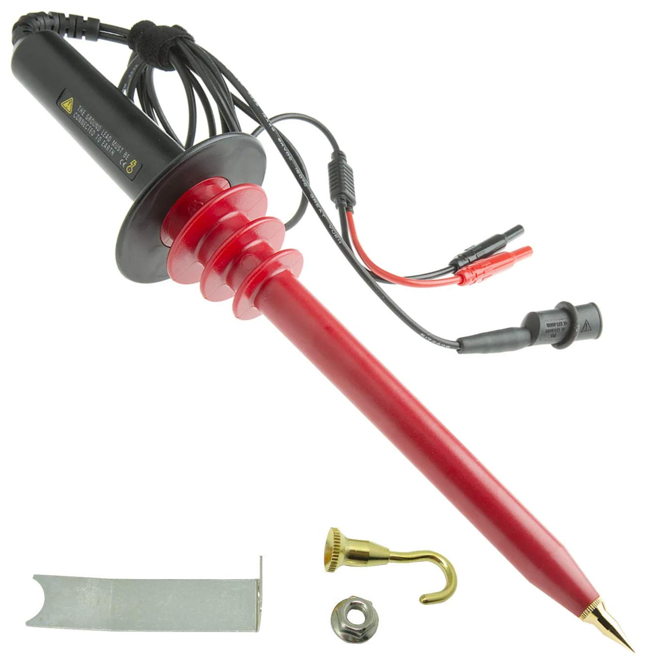

BTW you can measure the HV with a meter or a scope using an HV probe. A purchased version of what you built.
… connected to a DVM or scope. Test it carefully before you hook it up so you do not fry something.

My probe for my VTVM/osilloscope disappeared a years ago. I looked into this, but I’d have to break the insulating barrier to really go to the line. I’d prefer not too.
