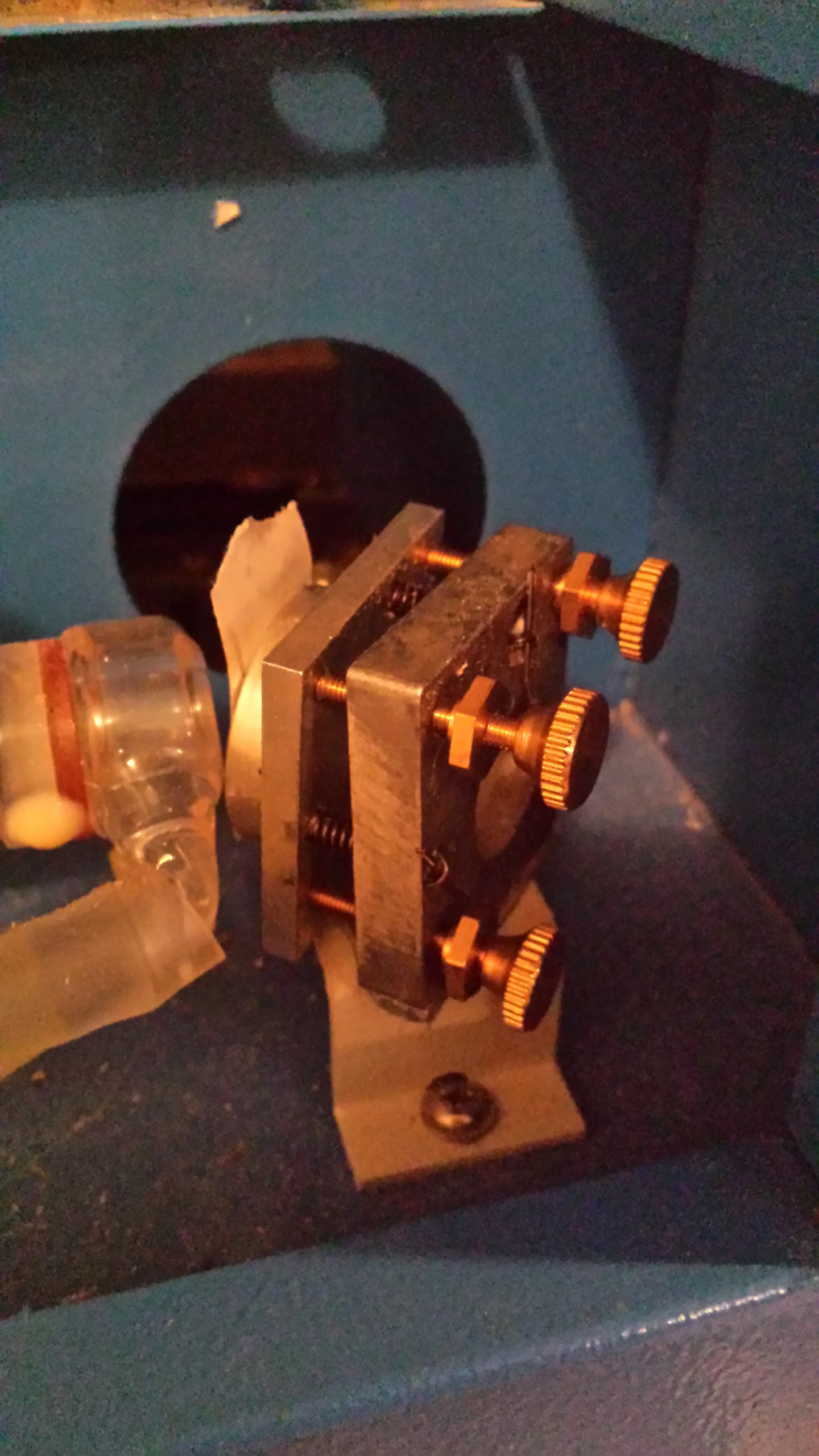

I’ve been working on my laser all weekend and unable to get the beam to the centre of the mirrors the picture is the first mirror and the tube .
Would this affect the cutting of the laser if they weren’t centre

Being in the center of the mirror is not required. But the beam must hit the same spot on each mirror regardless of the head position.

Your laser tube is too close to your first mirror- mine is at least 20mm away
