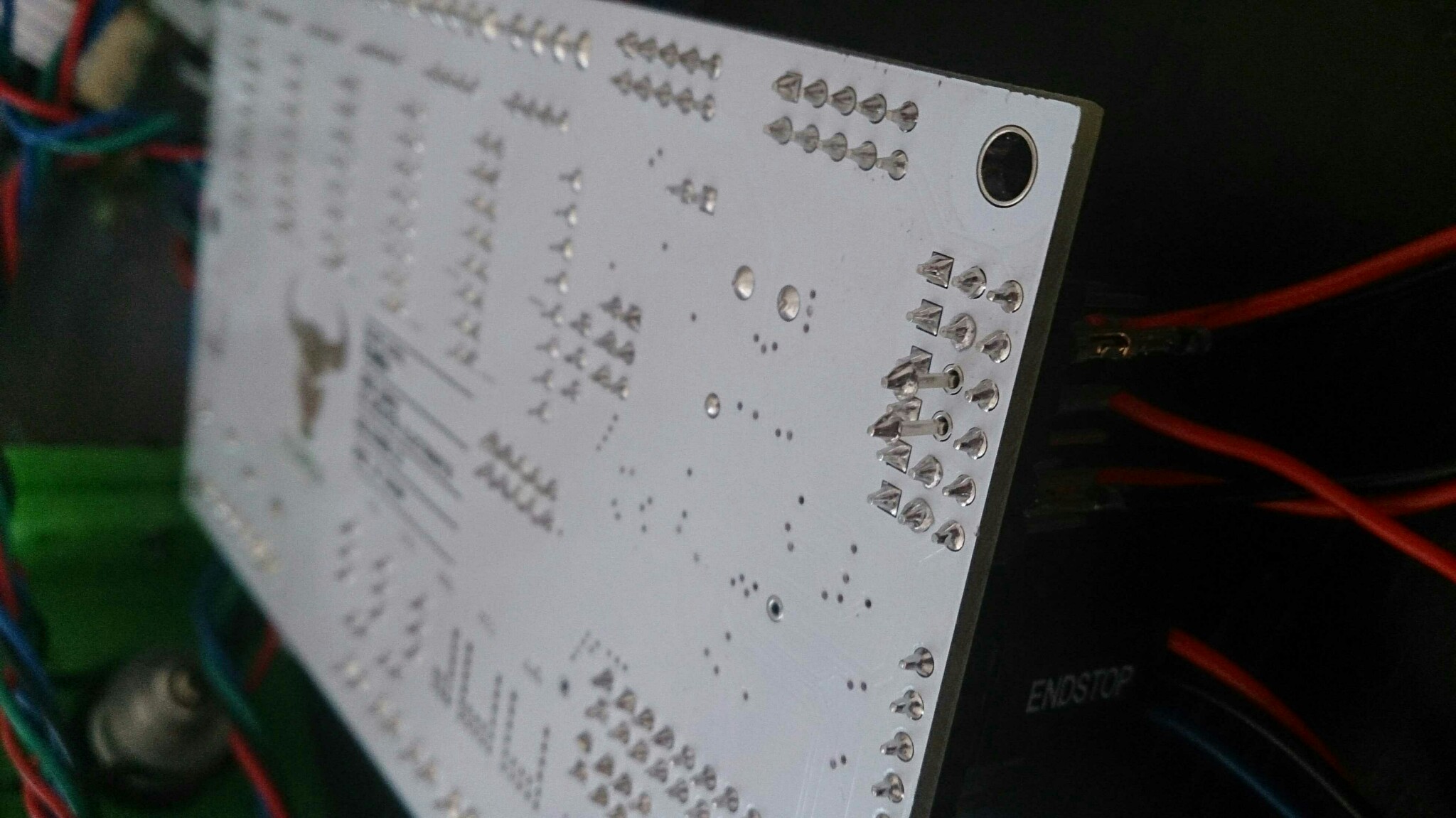

Hmm, I wonder if this has anything to do with my endstop not registering
Hmm, I wonder if this has anything to do with my endstop not registering :stuck_out_tongue_closed_eyes: @Thomas_Sanladerer @Richard_Turnock @ThantiK
I flipped the Rumba over after noticing that one pin was shorter than the rest, it looks like the board has more than one cold joint, but thankfully the pads are intact.
I’d like to point out that I have been in no way abusive to this board and have never used it until the last few weeks.
It looks like the z pin has a cold joint too, I’ll re-solder all the pins to be safe though. Hopefully this will be the end of this problem.
Looks like it to me. Just solder it back, unless the copper lifted from the board.
@ThantiK apparently I did wire it wrong, by connecting the motors to their corresponding drivers? I think this must be a problem in the firmware, the x axis endstop stops the y axis from moving, and I can bet that the rest of the axis are screwed up as well.
@Nuker_Bot_NukerBot_3 , the pads were still intact, thankfully the soldering job was so crappy that it perfectly detached from the board (if it was ever attached)
Damn. I had to solder some of these boards from China they aren’t all created equal. Sometimes the metal traces on the boards lift up then you are screwed. Clean the solder off and flux paste the 2 areas this should make a better bond.
The closer I look at your picture, it seems you may have separated the metal contact that brings the power to the board from that hole.

hopefully you will be able to fix it. You might also be able to do a software hack with the firmware to tell marlin to use another endstop for this axis.
that’s what I’m about to try, I switched pins for xmin with ymax as it doesn’t seem to register. hopefully it’ll work!
and it works!
Huzzah!
These boards really had a bad solder job done. I also had to go over mine and make repairs, and remove the solder from the mounting holes…
