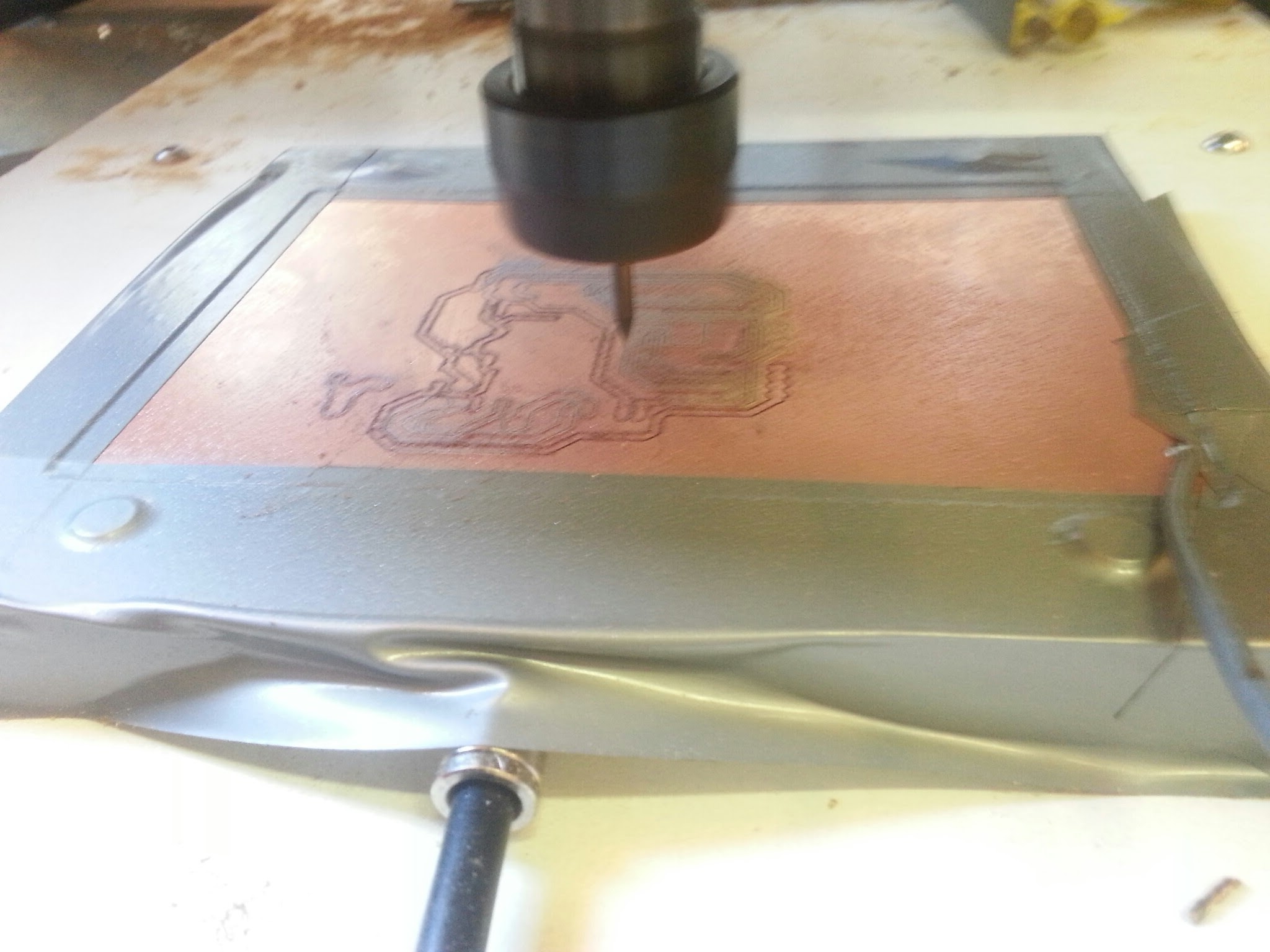

Here’s how I do it. Pretty much removes the need to auto level, as the base is machined level. It’s a piece of mdf which is porous, just paint the edges to seal it.
If I did it again I’d make it a perfect fit for the boards I buy so I can flip to double side. Just need to clean up the internal corners with a chisel. I am using a cheap 2 stage vacuum pump from eBay.
@Paul_Shaw so you just drilled a hole in the side of the MDF and stuck the fitting in? Is that duct tape that you’re using to seal off the area around the board?

@Marcus_Wolschon right but it’s just a fitting attached to a chunk of MDF? It’s porous enough to allow the vacuum to pull down on the entire surface area of the top?
Yeah, I’m wondering that too. Is MDF porous enough without any modifications to make this work. It’s a pretty cool idea if that’s the case. I’ve never seen that idea before.
A friend of mine has a 4x8 CNC router that has a vacuum table that pulls through a solid MDF spoil board, so it definitely can work. Just curious about pulling vacuum from the side like this.

A guy in our club uses mdf, cut into strip and layer on side, the mdf flows vac thru it very nicely at the edges, not as well on the top or bottom surface.
My plastic plate was tested yesterday. It stays mounted to the back of the mill table out of the way. Once mounted, a scotchbrite disc in the spindle run over the surface true it up. I put a piece of construction paper on it, turn on vac pump. Only way to get paper up was to peel from corner. This is just used to engrave thin brass and aluminum ID tags for equipment. They get rivet on.

Yeah I drilled a hole in straight behind the fitting but don’t think it needs it. The fitting is tapped into the mdf bit of thread sealant on it. The tape is just a wide pvc tape you could use electrical tape just have to take care to cover the edge of the of the board
