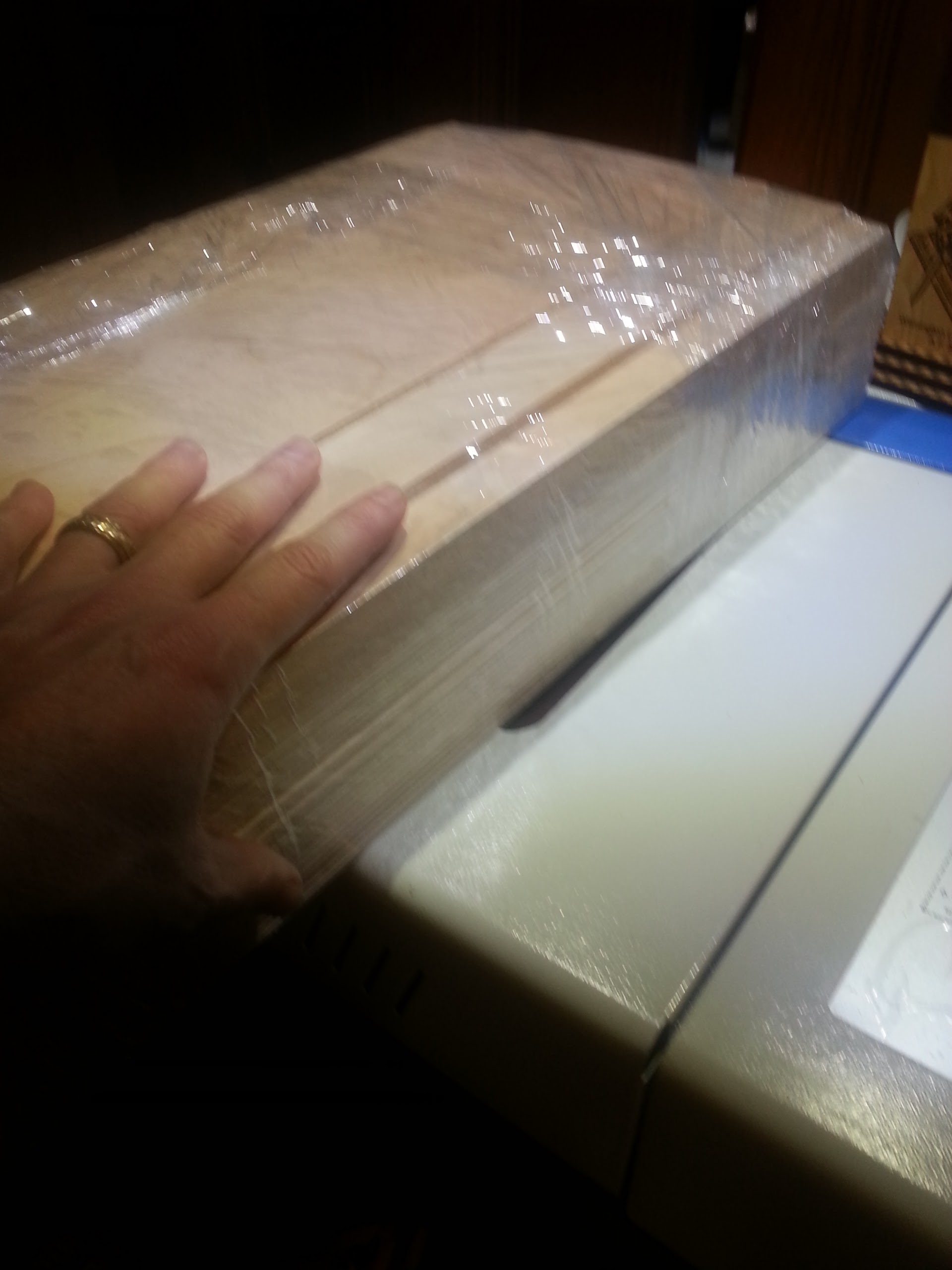

Hmmm..that feeling you get when you recieve a nice big package of wood to
Hmmm…that feeling you get when you recieve a nice big package of wood to cut/engrave. I asked the wife if she like my big wood package, sigh…she was not impressed :wink:

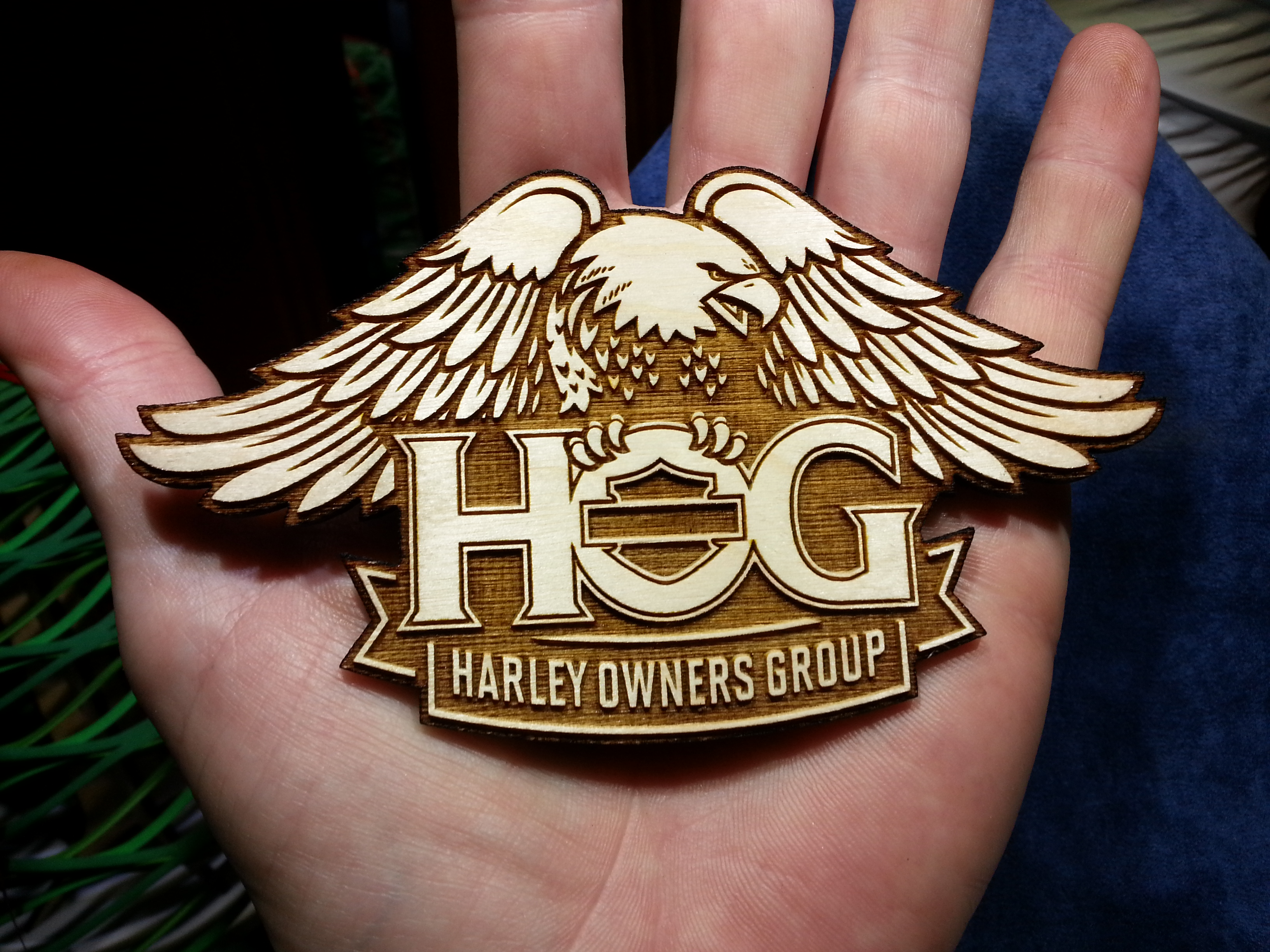

Lol, it was a mix of alder wood and 1/8" birch ply from Ocooch Hardwoods. I had a bit of a last minute order for 100 Harley-Davidson Owners Group (HOG) logos that completely consumed my stock of 1/8" alder wood and I had to restock and grabbed some 1/8" ply while I as was at it.
Beautiful work ! Smoothie?

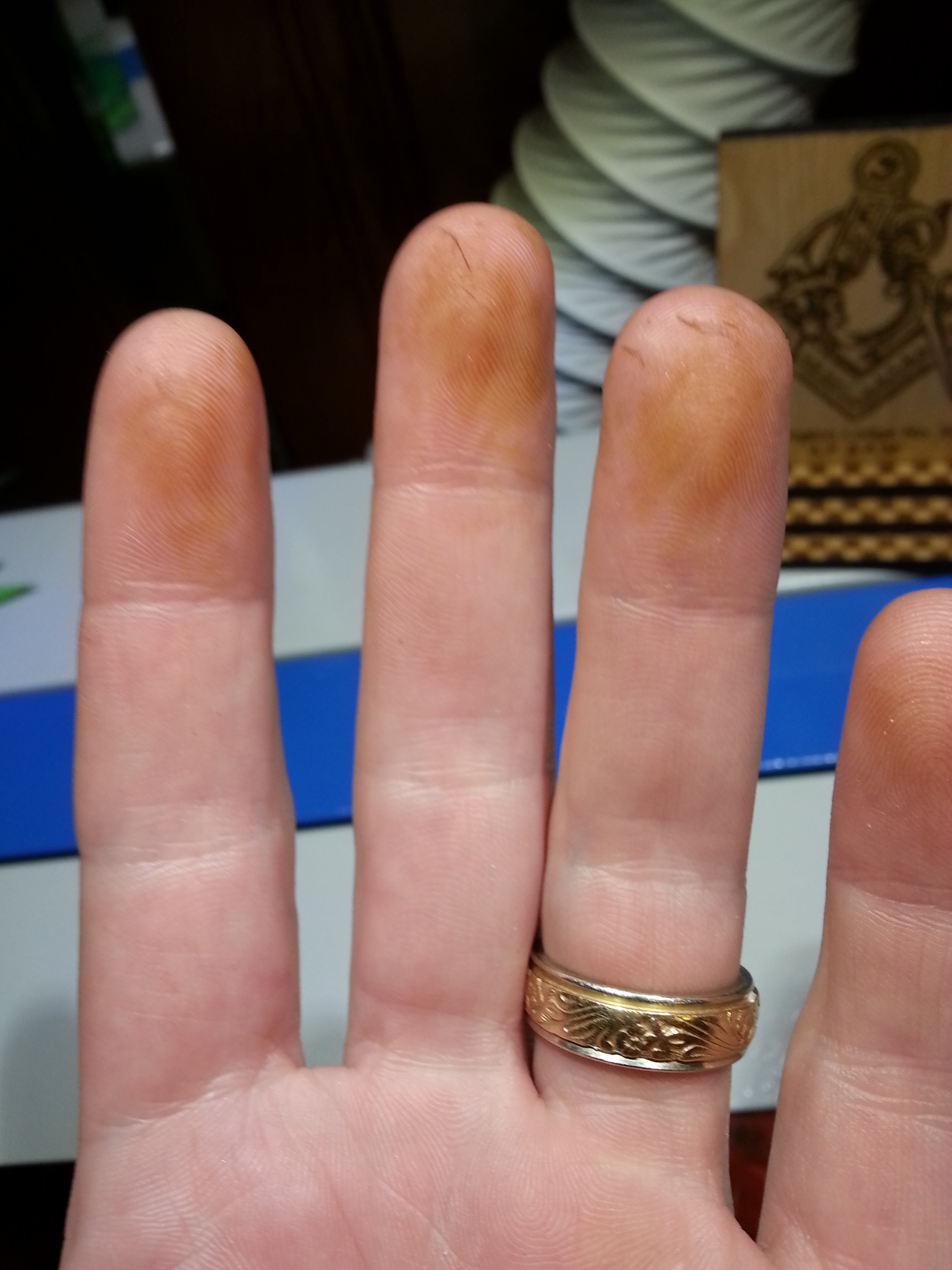

Lol, after handling a 100 of those things to get the masking off, that laser residue crap really will stain your skin.
Yes it does - sticky stuff - tried everything to get it off stuff - rubbing alcohol seems to work OK
That looks great, never though about using masking tape to keep the fumes from making the wood lighter.
Yeah I wanted a clean look since there was a lot of engraving to these pieces. Use a light tack masking tape and use some heavy tack duct tape to help remove. Found on this order that it works best to lay a paper towel over first and work in with a soft rubber ink roller to suck up the bulk of the residue before using the duct tape. That way it works faster and uses less duct tape.
