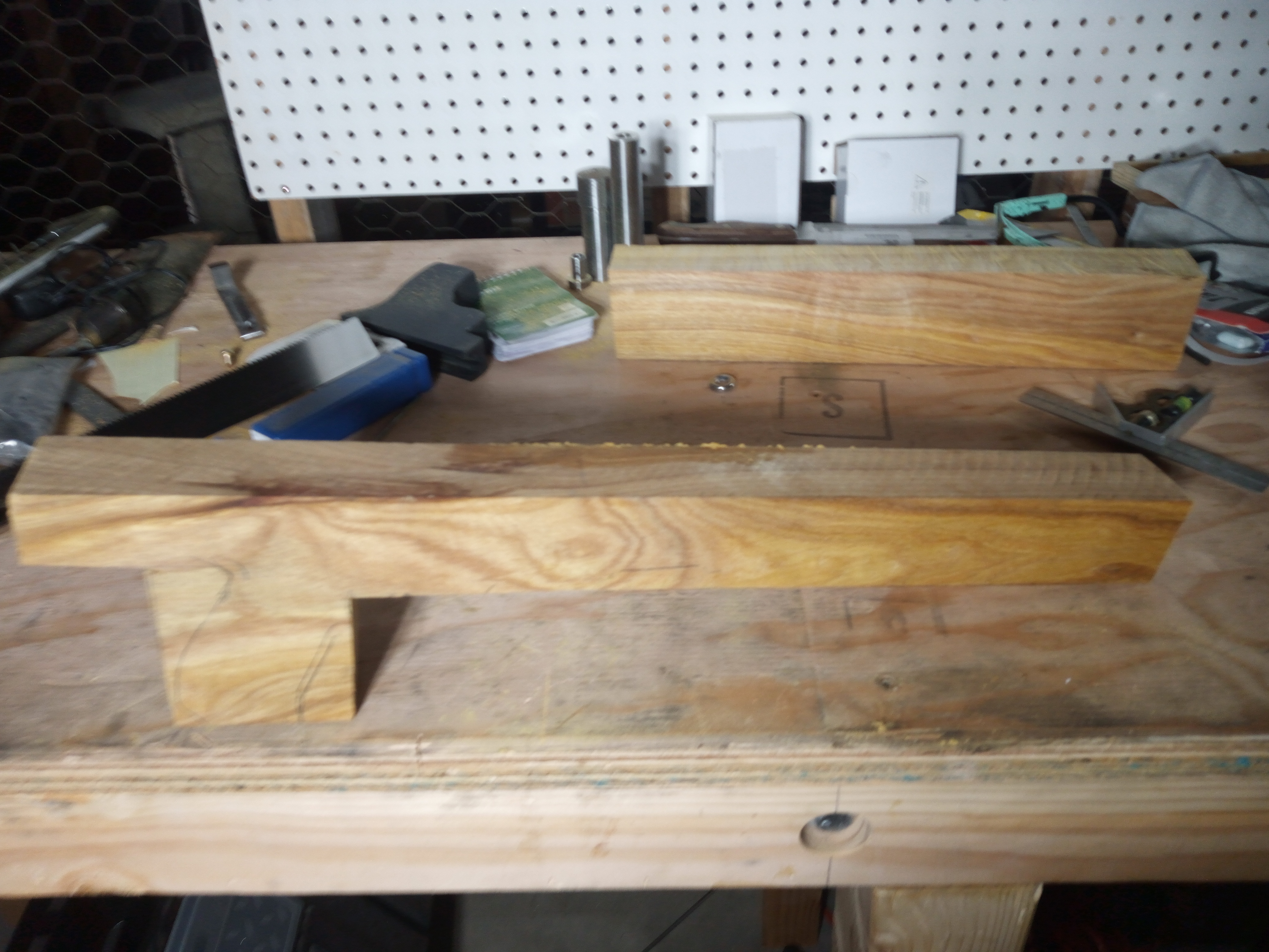

I’ve been working on what I would consider my first big wood project other than small stuff on the lathe, my workbench, etc. It’s a stock for a Savage A17 rifle. The one it comes with is injection molded plastic, is too small, and is a traditional style. So I decided to make one of my own with a pistol grip. It’s not quite finished. Waiting on parts to complete the stock. It’ll have a folding stock made of canary wood and 30mm carbon fiber tubing. Anywho, this is what I’ve got so far. Any tips, tricks, or criticisms are welcome.
I inletted the action, magazine well, and barrel channel using a milling machine, then made adjustments as necessary with hand tools.
I’ll upload more to this thread once I get more parts and finish it up.
Blank cut from a 2x6x5’ piece of canary wood. I broke this one and had to start over
Thanks for looking!

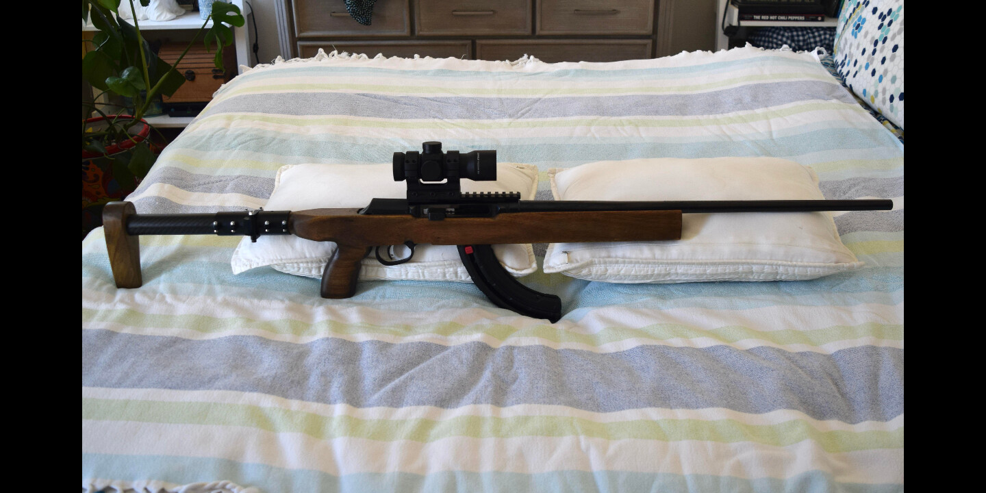

Hey guys! I am very nearly finished with this project. Let me know what you think!
I used a pewter finish to bring out pores in the wood and to make it look a little dirty by default. I intend to use it as a truck and target practice gun, so it’s gonna get dirty and banged up. I made the butt end of it out of carbon fiber tubing and an aluminum locking hinge made for large drones. There’s an aluminum stopper in the butt pad, so you can use the tube for storage.
I think that it turned out superb.
Tell us more about the pewter finish I am not familiar with that.
Thanks! Sorry, I misspoke. It’s a pewter stain. It’s a grey/black sort of oxidized metallic looking stain.
