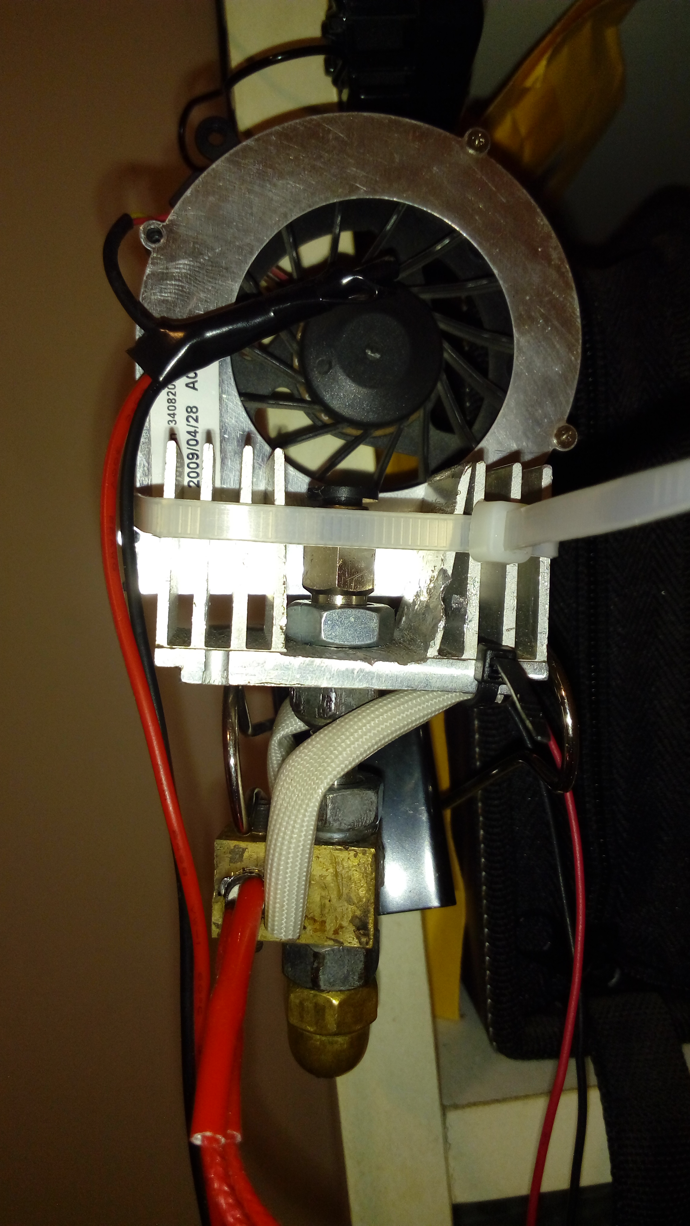

“home made” #Bazooka #hotend for #QR1500. 1mm nozzle
full metal or with ptfe inside?
ptfe only on upper 1/3 length, for guidance after the Bowden fixture. The rest of 2/3 is full metal.
I also added a “buffer” for fast melting/mixing. might cause problems on retracts, but test will tell.
Video of print, please!
