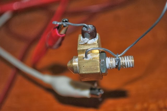

Home made Nozzle: 2nd Attempt.  Now with a bigger resistor.
Now with a bigger resistor. I actually reach 250°C easily. I’m quite happy.
Not really aesthetic… but well, if it works!! :slight_smile: Thanks to everyone that helped me and gave me tips on my previous post.

@Donald_Y_East I actually took dimensions I found in the Reprap.org website. I want to make sur it’s a valid solution before sharing it. But it’s planned that I’ll share the design. it’s not really pretty or new anyway. it’s really classic.
@John_Ridley Thanks for the tip. I’ll check ebay for that. Here I’m using a 8W resistor. Seems to work ok.
