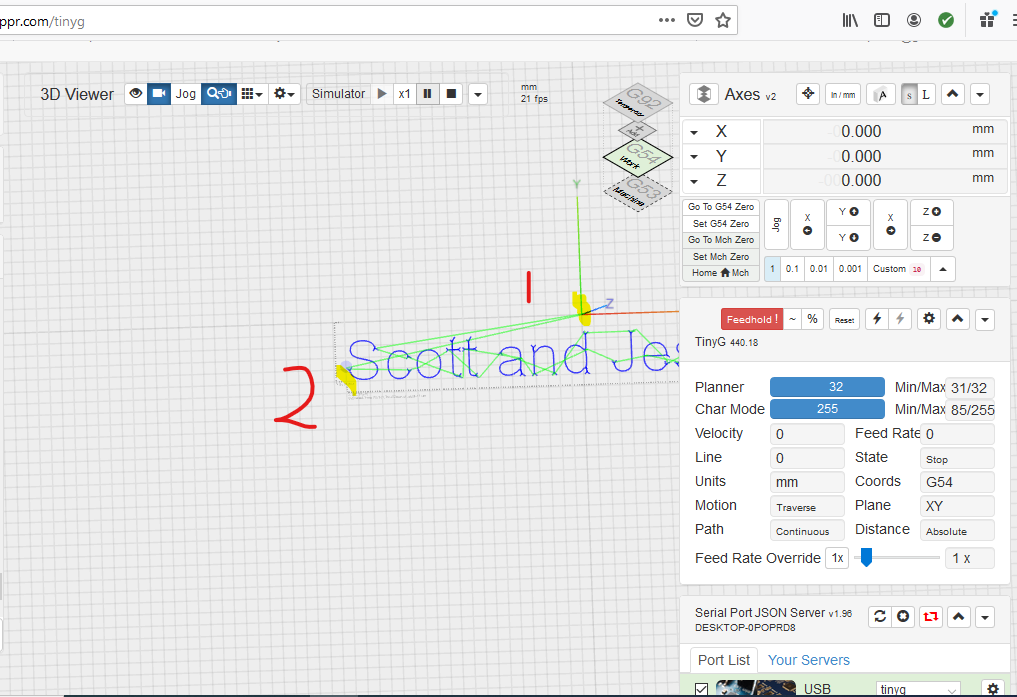

What I have been trying to work out for the last few weeks which I have not been able to work out for the life of me, I have sent an entry point in Fusion 360 to the bottom left corner of a work piece. I have manually set the z height, and x/y to start at the bottom left of the work piece however from what i can tell, chilipeppr doesnt know that is the case and moves the cutter way off the work piece and starts cutting. I have drawn something out to hopefully explain this a little better.

Perhaps your work coordinates and machine coordinates are offset from each other? Keep in mind ChiliPeppr doesn’t do anything other than send Gcode to your controller and get back data from your controller. So this is your controller, not ChiliPeppr. Can you post a full screenshot, especially the Axes widget and make sure it shows your machine coordinates from the Grbl widget as well in the screenshot.

As you can see from the screenshot, point 1 is where Chilipeppr wants to start from yet point 2 is the entry point/point which i have set (i think i know how to do this) as home through Chilipeppr.

I think you need to reset your home position in your gcode generating software. It’s pretty clear to me from the screenshot that your 0 position is not the lower left corner. Maybe post screenshot from your cad app.
